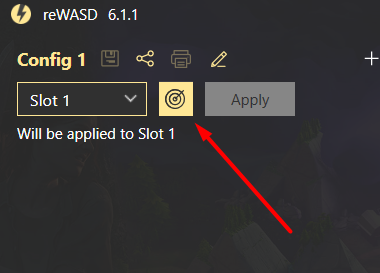

    I understand correctly that the configs are applied manually, and the problem is only with the autodetect?
    Do you have radar enabled for these configs?

        All my configs are set to auto detect the .exe and apply the reWASD profile once running. I have the radar enabled for all configs. I can't get reWASD to apply my configs to the profiles I modded on the W10 professional PC to the W10 home PC. They won't work manually or automatically.
