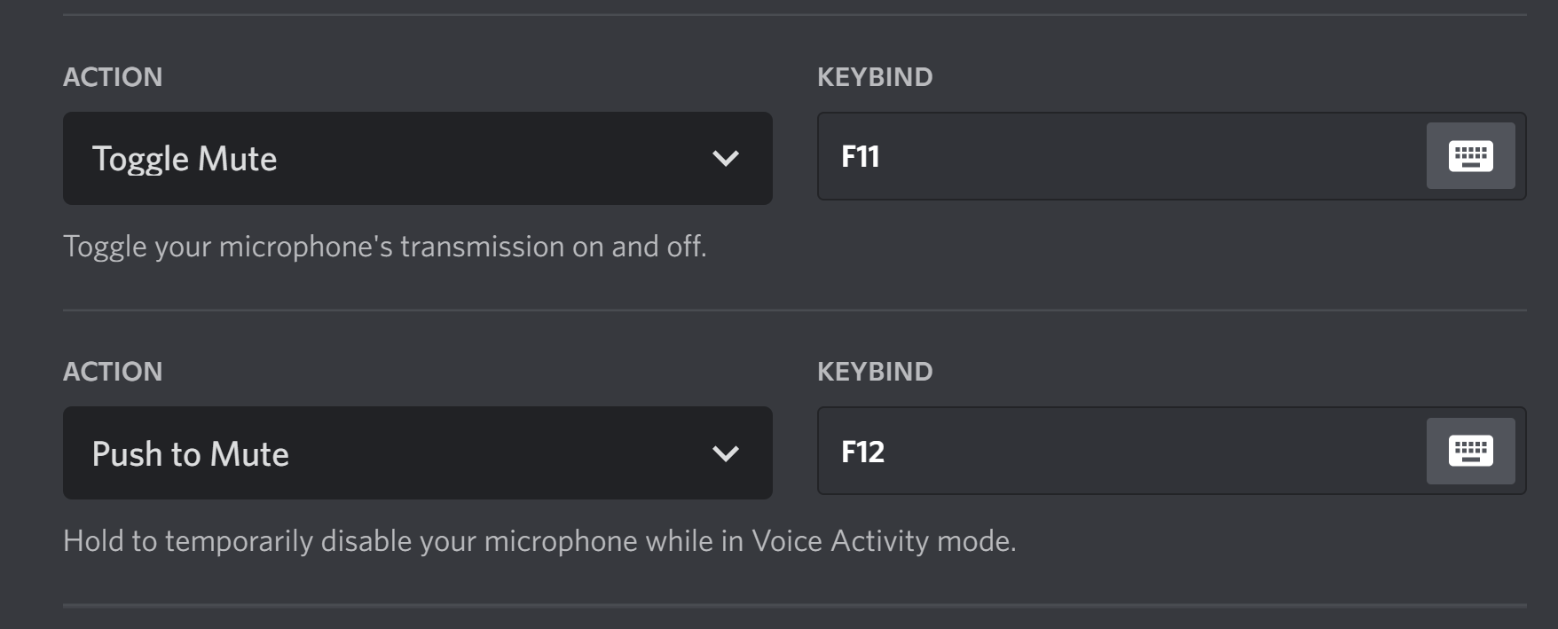

    1. In Discord app, set different hotkeys for Toggle Mute and Push to Mute:

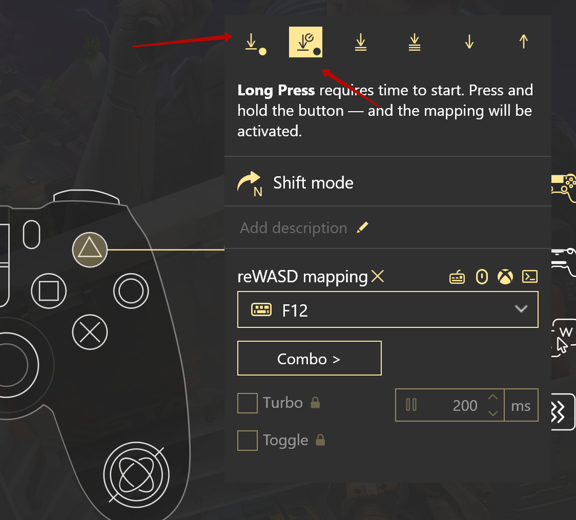

    2. In reWASD, set Toggle Mute to Single Press and Push to Mute to Long Press. This is an example:
    Click image for larger version  Name:	3ef67df367.png Views:	0 Size:	321.6 KB ID:	231797
    This way, a single tap will Mute the microphone, while if you press and hold the paddle a bit, it will be muted still.
    Please note that there is a small delay before Long Press starts working — to be sure that it doesn't overlap the Single Press mapping. You may change this value in Preferences ( at the bottom right) -> Press Time tab.
