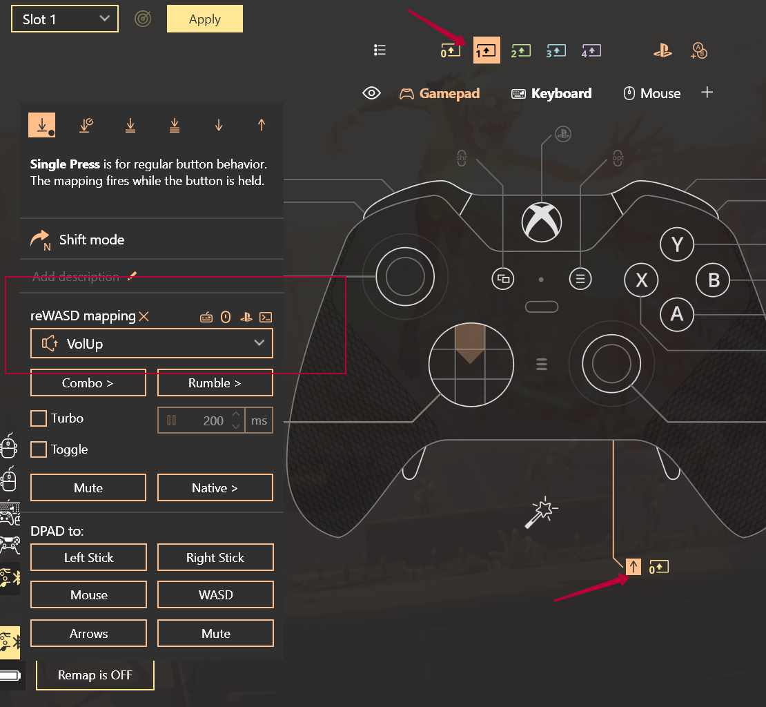

    You should use Shift mode instead. Your paddle should be a Shift Jump, and you should map Up and Down buttons in the correspondent Shift Layer. Check our shift mode help guide for more details. Something like I have here:

      I see, guess that works as well, was just used to how CC worked but this way might actually give it more modularity.
      Just bought an Xbox Series X controller (appaling bluetooth support from Microsoft lead me to buy your software, enjoying it so far) and using Share+Shoulder buttons to cycle through the modes is easy enough. Cheers
