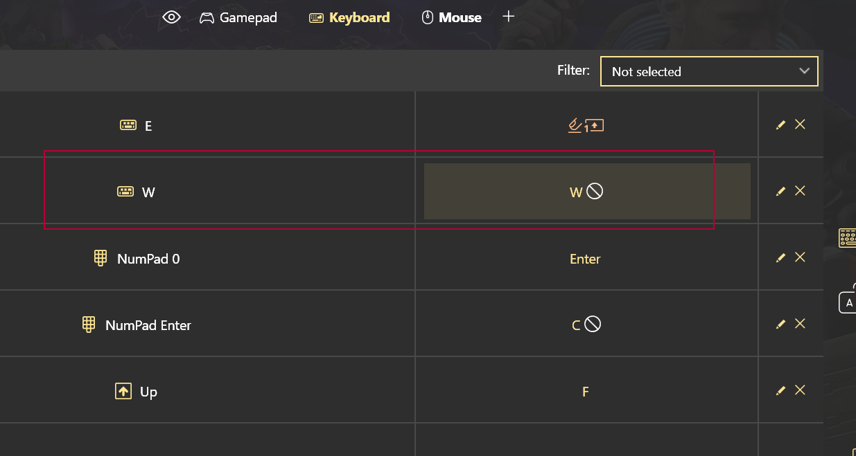

    There is an issue with the keyboard keys indeed, and we will do our best to fix it in the upcoming releases.
    Right now, you should remap the "target" key to itself and mute it in Main layer, this way:
    I have attached your config with this small fix, hope it will work in your games.
