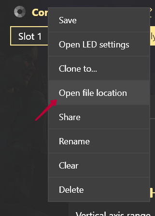

    If you still have questions, please share your config with me, and I will try to add required Jumps by myself. The easiest way to get to the config file is from the context menu:
