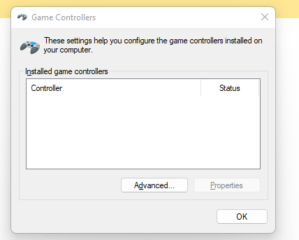

    2. Is your controller detected on Windows when connected via Bluetooth? Connect your DualSense via BT, type joy.cpl in Windows search.
    Send a screenshot of how your gamepad is recognized in the opened tool.

      Hey, thank you for responding. I had trial for rewasd and when it expired I bought a key after i bought the key it stopped working. I have attached the screenshots you requested.

        Thank you for the information provided.
        For some reason, your DualSense is not recognized even on your system when connected via BT.
        However, your controller is in the list of connected Bluetooth devices.
        Try removing the Wireless Controller from the Bluetooth & other devices list and then pair your controller again.
