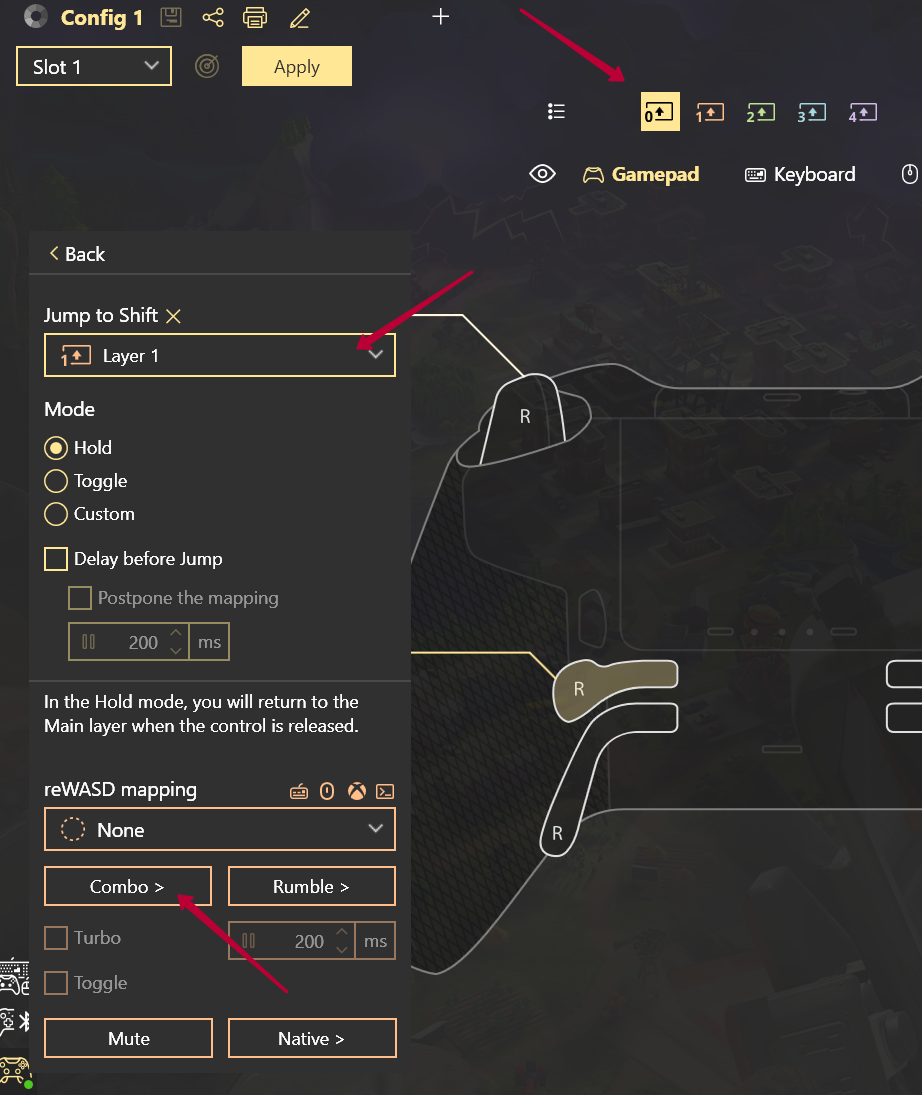

    Here is how it should be set up:
    1. In Main configuration (Shift 0), map your paddle to Shift Jump (Hold mode) and add your Combo here:

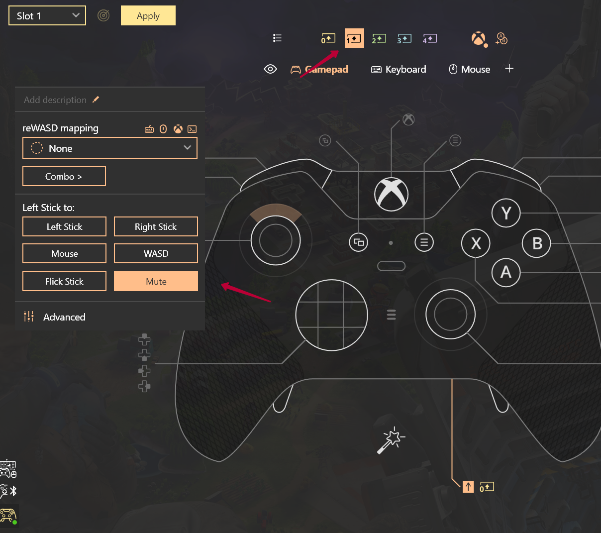

    2. Inside the Shift 1, Mute your stick (on my screenshot, I have muted all the directions):
    I hope it could help! If you have other setup and I am missing something, please let me know.
