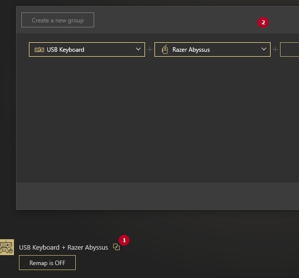

            Please specify the following:
            1. Do you have the Advanced mapping feature? This can be seen in the License section → Advanced mapping tab.
            2. It may be a chance that something is wrong with the device initialization. Please show me your group, like here:

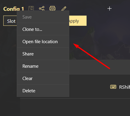

            3. Please send your config.

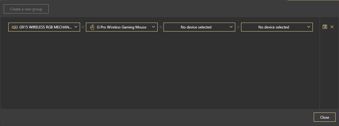

Name:	rewasd group.jpg
              I did blacklist these because when I tried to use the detection on it they both showed keyboard.

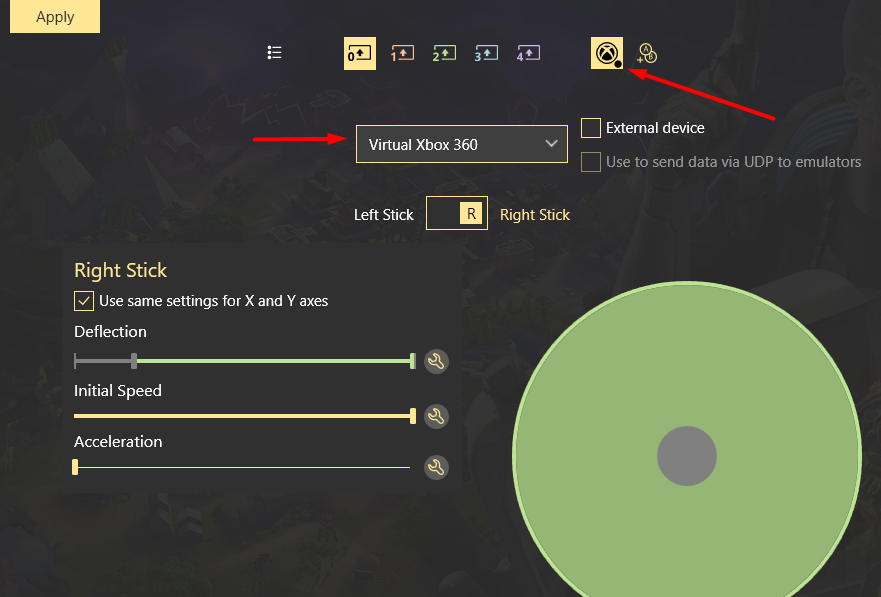

                Please disable the physical controller, apply the config and check if the virtual controller works in Gamepad tester.
                Also, try changing the virtual controller type to Xbox 360.
