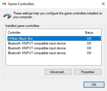

    I closed out reWASD, then tried loading it again while watching this list. It populated once with the XINPUT device, but still Nothing is applied. I tried again, and it added another iteration of the same device. Still Nothing is applied. Etc.
    Previously, I had seen a similar thing going on, but didn't notice it while populating (only after). But it was Azeron device being listed, not XINPUT. Any clues there?

      I rebooted my PC again, and this time when I launched reWASD, rather than making me select the profile, it loaded it automatically. Also, instead of saying "Nothing is applied" in the lower left, this time it said "Remap is OFF". So I was able to now click that Remap button, and it changed to "Remap is ON" and everything was working fine. Any idea what might be the difference between these scenarios? I can't think of a single thing.
