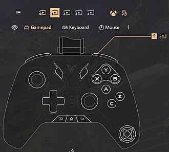

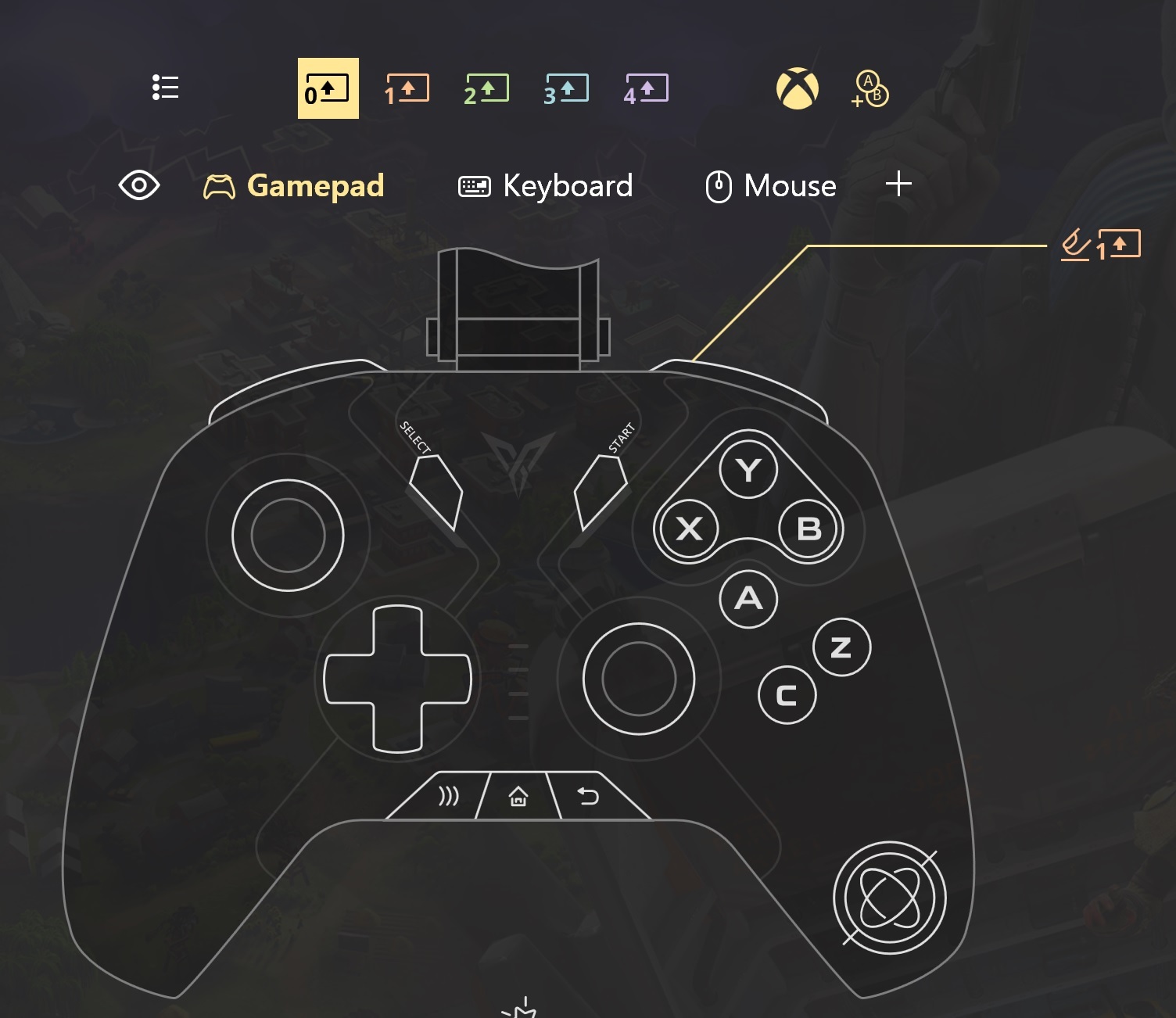

      0. main configuration
      Lt single press : change to slot1
      1. slot1

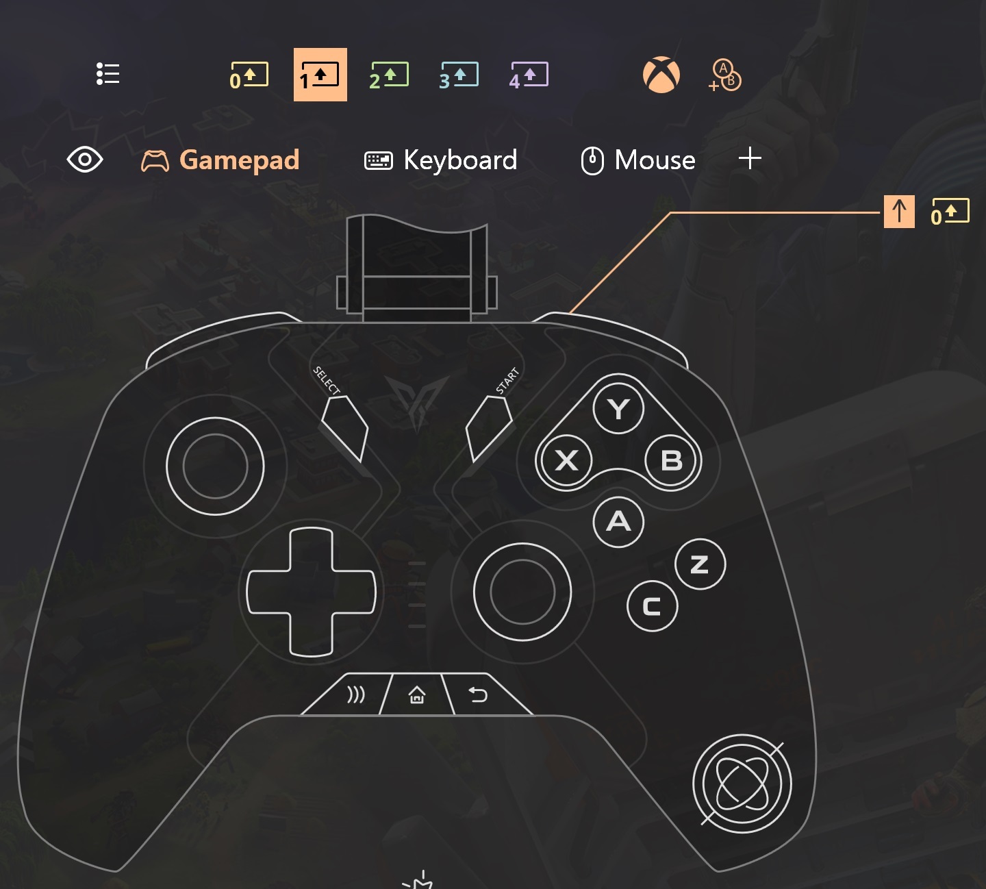

      Lt release press: change to slot0
      Lt single press -> press A -> Lt release press : I can map "press A" on slot1.
      Lt single press -> no other input -> Lt release press: I want to map an input on this kind of Lt release press.
      I know I can map an input on Lt release press. But I want to map an input on "Lt single press -> no other input -> Lt release press".

              Thank you for describing what you want in more detail.
              Perhaps I still understood something wrong, but exactly what you described cannot be done if LT is responsible for jumping to another Shift layer.
              Otherwise, mapping on the LT release will work under any condition.
              You can try the following:
              Make A, B or any other button you want mapped on another layer as a jump button in Shift in Custom mode and assign the input you want to that button on the other layer accordingly.
              At the same time, assign a Single Press of the left trigger to return to layer 0 without mapping in the current layer.
              Finally, in layer 0, assign the mapping you want to LT Release.
                Wow. Thanks. It can be implement like that. Thanks again.
