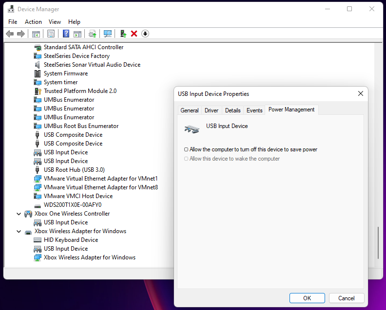

          Hello! Please check power management setting:Open [Device Manager] (right-click on the Start button for option to appear).
          1. Set the [View] to [Devices by container].
          2. Find your controller.
          3. Check your Xbox Elite controller for a [Power Management] tab and disable [Allow the computer to turn off this device to save power] option there.
          After that, you might need to restart your PC once.
            I have ensured that every device listed under the Xbox One Wireless Controller and Xbox Wireless Adapter for Windows containers have "Allow the computer to turn off this device to save power" disabled, then restarted my PC. The issue is still occurring.

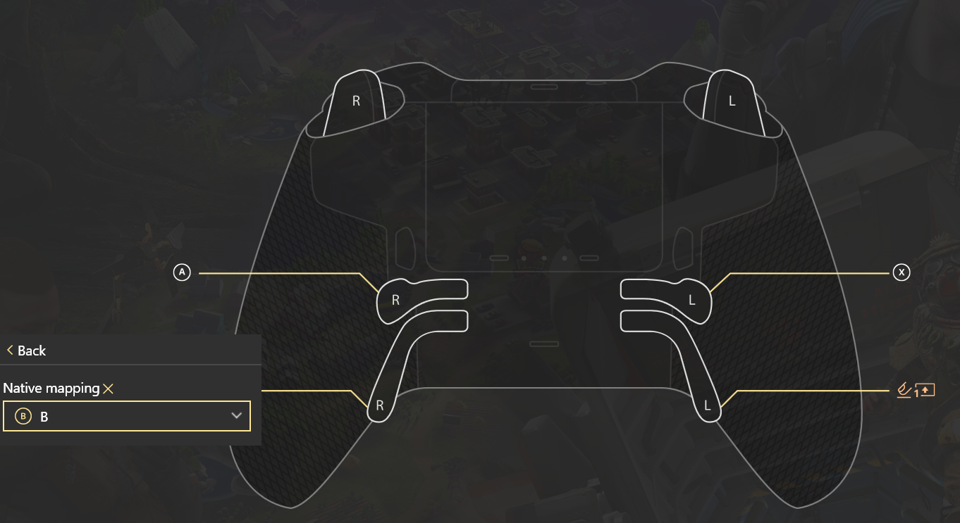

                            Your RetroArch config includes the keyboard and mouse mappings only, there is no controller mappings inside. Your Xbox One controller uses the virtual Xbox One controller, which, I think, it doesn't need. If you remove the virtual controller mappings and change them to Native mappings for paddles, then the config will work pretty much the same:
                            Click image for larger version  Name:	8ca8ab5970.png Views:	0 Size:	665.0 KB ID:	232989
                            If the same is true for other profiles you use, then, it would be a good idea to remove all other unnecessary virtual controllers.
