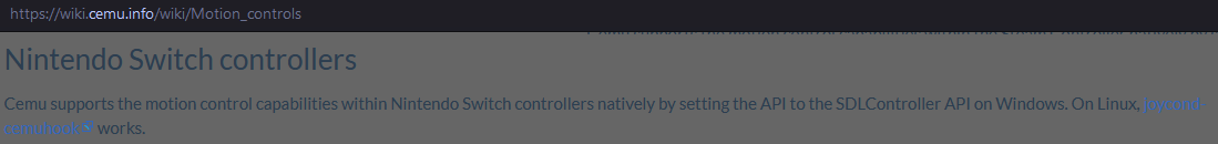

              Cemu does have support for Switch Pro controllers. My 8Bitdo SN30Pro also works well with it. CemuHook files are on Cemu folder as well.
              There are no other remappers drivers installed. ViGemBusDriver and HidHide were the only ones. Without them XOutput and x360ce don't work and they are portable.
