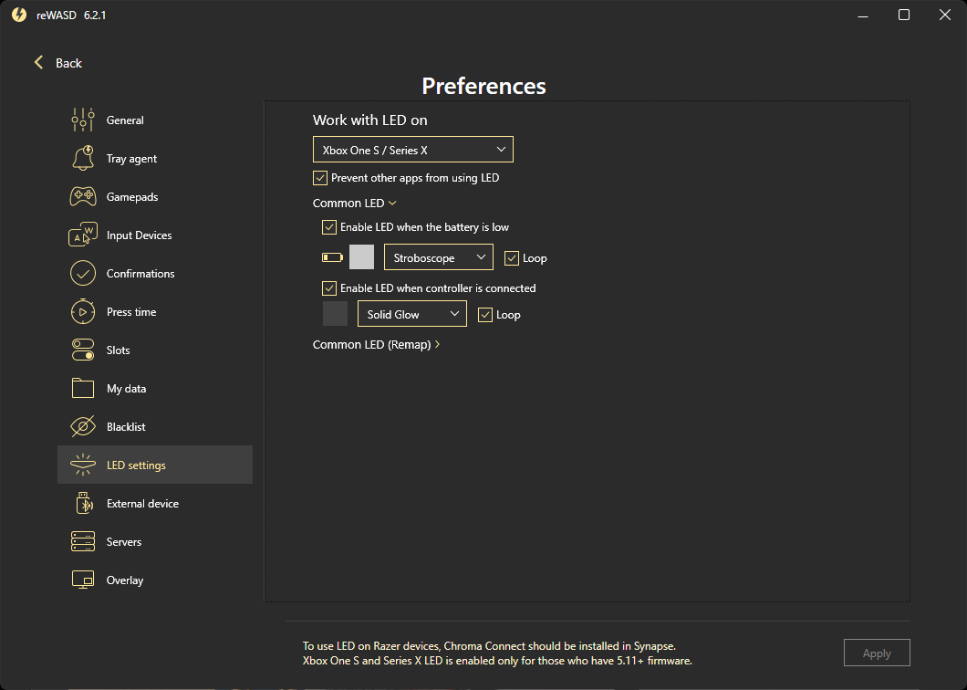

    When i turn on the controller the LED is always at 100% brightness, and stays this way until i click two times on reWASD icon on taskbar, or open the app.

      1. Xbox Series X controller, firmware 5.13
      2. Type of connection: Xbox Wireless Adapter
      3.
        Try to replug the device, open Preferences — General, and click Clear data.

          Also, please clarify whether the LED problem appears when the config is applied or not?
            Clear data and replug device didn't solve the issue. Yes the config is applied when i manually launch the program.
            After some testing, only the "Solid Glow" option does not apply automatically. When i select "Shimmer" then it works as intended.
              If the config is applied, then we may need more screenshots for the LED settings:
              1. In Preferences, there is Common LED (Remap) section which defines which LED effect will work if the config is applied to some slot. It may be a chance that this one is set to 100% as it is by default.
              2. The config itself may include the LED data. Please check if you have something non-default there:

                I don't have any remap or config settings. Maybe its my wireless adapter that's not good. But its all too much work only to make a LED dim. I'll go back to bluetooth + electrical tape combo. I don't understand why Microsoft doesn't let us officially adjust the led lol.
                  With Bluetooth connection, there is no way to adjust the LED at all
                  As for the adapter, if LED settings are set to default in the config, then Common LED (Remap) section should show the level of brightness you get once the config is applied to the chosen Slot.
                    What i do to avoid this bug i set the LED to Shimmer and disable loop. So i turn on controller the led Shimmer one time and turn off.
                    But i still think program is bugged since Solid Glow option does not apply automatically - i've checked every option.

                      According to what I see in the log, reWASD sets the LED to dim light. If you use Solid glow mode, then we send this command only once. If you use Shimmer mode, then we will send different commands all the time the condition is met (remap is ON, controller is connected). It seems that after reWASD sets its color, something else interrupts us and sends additional 100% color. This may explain why the behavior differs.
                      Do you use Steam? Please check if you have enabled Xbox Extended Feature Support there and if yes, uncheck it and restart your PC. Then try to Clear data in reWASD and set the preferable colors and try again.
