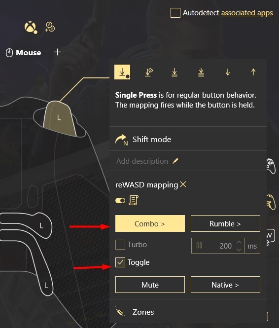

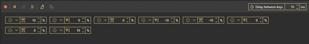

    Hello! Try the Toggled "circle" combo. Basically, you would need a combo that mimics the square or a circle, so it would be something like this:

      Toggled circle combo? Where do i find this?
        First you need to create a combo like in the screenshot in the previous post.
        After that, enable the Toggle checkbox.
          It does not ADS like this and seems to continue the combo constantly after the L2 button is released

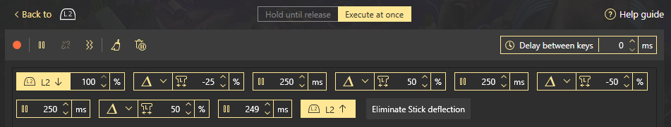

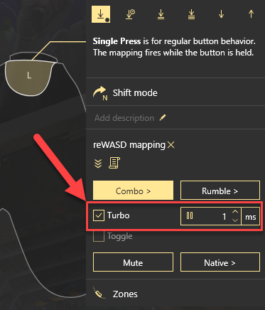

            Hmm. Constantly strafing left-right while having the trigger held down would require two inputs from the same button, which reWASD is unable to do yet.
            Though there is an alternative that should work most of the time:

            These settings would briefly (for 1ms) release the left trigger while moving the stick to 25% deflection left-right 4 times a second. I'm using relative deflection nodes to avoid overriding by the native stick movements.
              That seems to do what I wish, Thank you! One question, where do I find that eliminate stick deflection command at the end of your combo?
                To get this, you need to select the relative deflection for the stick movements in the combo.
