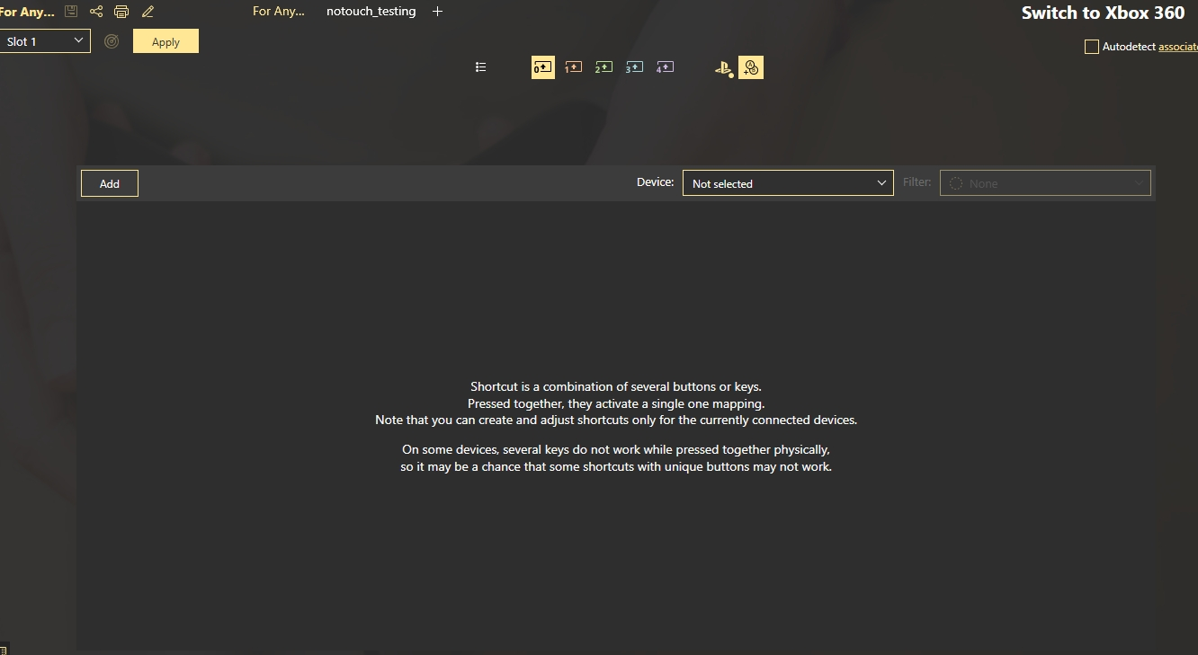

          here it is
            The config you have shared does not have any Shortcuts set in it.

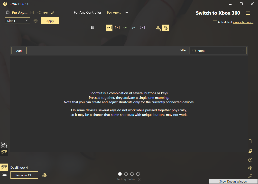

            And the [Combo] you have set for the [Right Mouse Button] would run only as long as you hold the [RMB].
            If you have previously added a Shortcut that uses the [RMB], it would add a slight delay to other activators of that button. The delay is required to determine whenever an activator or a shortcut must be used. The delay can be set at Preferences > Press Time.
            If this is not the case, please explain what you mean by "shortcuts" and describe the steps you made in more detail.
              sorry just realized I posted it without the shortcuts, here is the config
                It's pretty weird, but I can't reproduce your issue either, since the updated config doesn't show the shortcuts.
                Could you recreate this config from scratch and send it to us again?​
