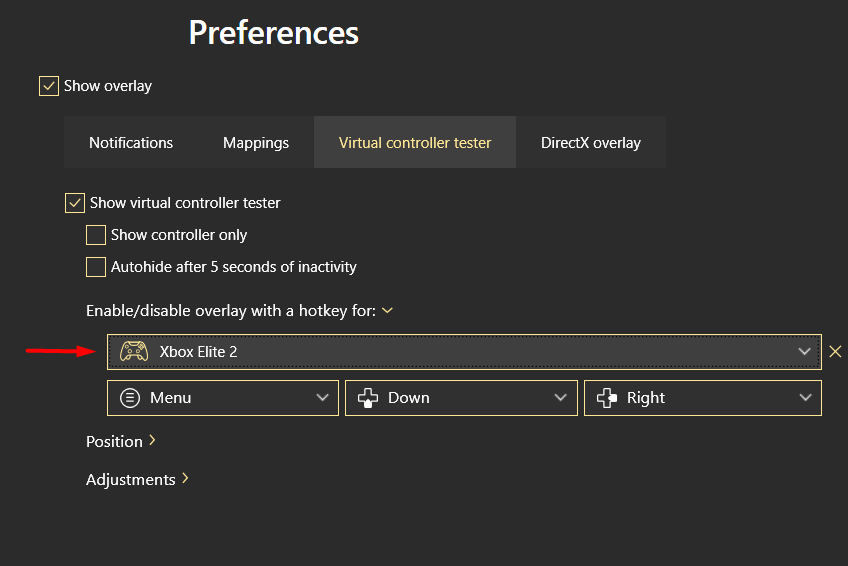

    It is possible to test our virtual controller with:For the latter to appear, you have to apply the config and press a shortcut you can set at [Preferences > Overlay > Virtual controller tester > Enable/disable overlay with a hotkey for].
    The device you chose there doesn't have to be your Azeron.

        Perhaps you have selected the wrong device or keys. ​
        Also, Virtual Controller Tester overlay is only available if a virtual controller is used in the config.
        You can send a screenshot of your config for us to check.​​
