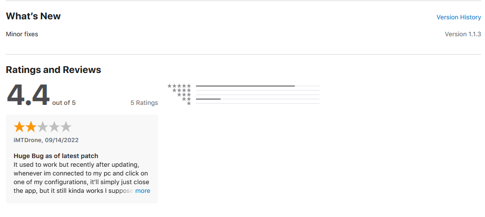

          Never mind I see that ios version has not been updated yet. Hopefully it can be updated soon. I see others are having the same problem as me.

            Hello! That's right, the new iOS version is not ready yet.
            We will let you know when the update is available.​
              The new version has been published in the App Store. Please check and let us know if there are any problems.
                Works perfect thank you so much for always helping and actually fixing problems. Thanks Again
