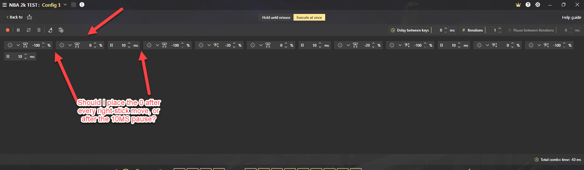

Not sure whats wrong but for some reason after I press a button to activate the combo on the FlyDigi Vader 2 Pro controller...it does the combo then constantly moves the left/right stick of the controller. It won't stop until I press another button on my controller. I attached a link to the video below so you can see what I mean https://imgur.com/a/MFRpvJp It randomly keeps moving the left/right stick. Combo is only about 2-3 seconds long but keeps repeating random left/right stick commands.
My combo does a constant right stick/ left stick loop after 1 button press

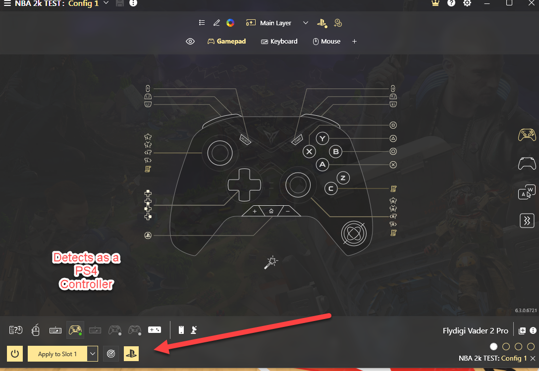

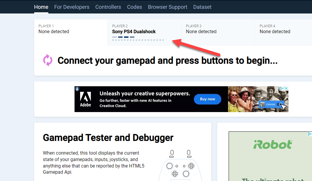

Sure. The website you provided just keeps saying "Connect your gamepad and press buttons to begin...". but I press buttons on FlyDigi Vader 2 pro controller and doesn't show anything.. My gamepad does work though as I use it during the game. Also I have ReWASD connected.. Another thing is on ReWASD it displays all the buttons exactly like a FlyDigi controller but has this playstation icon. Not sure if that mattersAttached Files
- Flag
The Playstation icon is shown because you are remapping to a virtual DS4 controller that is created by reWASD once you apply the config.
The thing you pointed out in your first screenshot is a tab where our virtual DS4 data would be shown.

No. You have the red arrow pointing to the tab in question on your first screenshot.Originally Posted by enyce View PostI attached another screenshot. Is this the Tab area you mentioned?
We would need a video of one of these showing your combo in action as an example, because we do not have this game:Originally Posted by enyce View PostI can move my right stick/left stick and see it move around in ReWASD.. but when I press the combo button. it no longer shows it moving my left/right stick. But will for sure do it on the game. Heres another video
https://imgur.com/a/BPqatPt- Gamepad Tester site, showing the data of our virtual controller.
