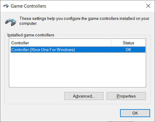

        Check joy.cpl to see how (and if) Windows recognizes your device when you use the Adapter to connect (this is a native Windows tool that displays all the connected devices). Open Windows search (by pressing Win keyboard button, for example), enter joy.cpl, and press Enter.​
          Windows Sees the device, device has the same name wired or plugged in.​
