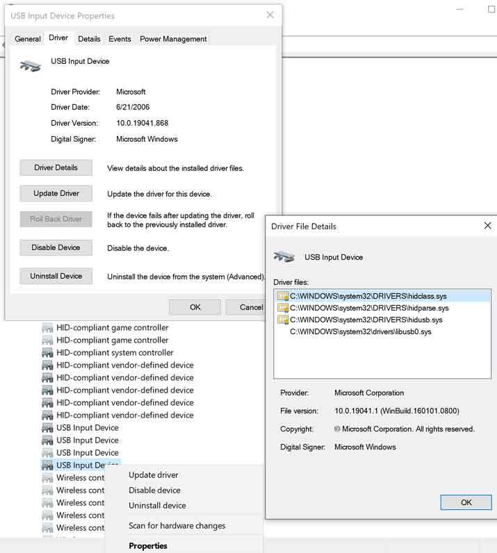

    e. extract libusb-win32-bin-1.2.6.0.zip to some temporary folder ... find there "install-filter-win.exe"
    if you have 32bit OS, use one in "\bin\x86" ... if you have 64bit OS, use one in "\bin\amd64"
    run it ... choose [Install a device filter] ... in next screen look for "Generic USB Hub" with Hardware ID matching VID and PID you found in step 4d ... choose it and install

    d. after install finish check your "USB Input Device" of your Virtual DS3 controller ... its driver should have "libusb0.sys" (you might need to restart computer after this)
