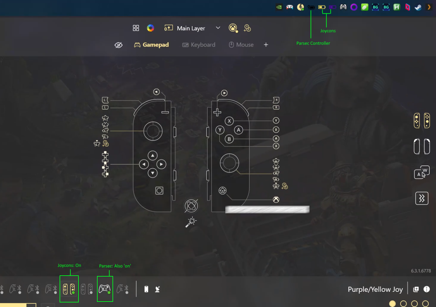

      What i am trying to solve is simply this: my parsec virtual controller is being 'turned on' in ReWASD anytime the joycons get turned on, below is a pic that hopefully will break down what happens:

      This in turn makes Windows think that my joycons are controller Forum more times than not. Let me know if that makes sense. I'm happy to provide more info / pics as necessary, i just didn't want to go too deep for now and make this more confusing than it already is I do know that BetterJoy is influencing this, but i have to use BetterJoy because it can pass the Gyro controls in Yuzu while still appearing to be an "Xbox 360 controller"; i have not been able to do that with ReWASD (Yuzu will see the controller as Xbox 360, but will not accept Gyro input).

        reWASD will "turn on a controller" when disconnected device that had a config applied to it gets reconnected.
        If you don't want to remap Parsec controller with reWASD, simply turn remap off for it.
        You probably should re-check your setup and look why Parsec adds a virtual controller every time you connect or remap your Joycons.
