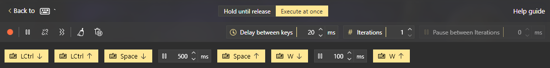

        A [Combo] like this should give you one jump move:
Name:	Screenshot 2022-10-16 050716.png
        Adjust the pauses if needed.
          ok ill try it tomorrow when im online and update you thank you
            sorry for the update it still not working i can't figure it out sorry for the bother

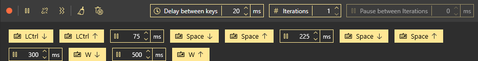

              If I understand correctly, the trick is done with a simple combo Ctrl + Space + Space + W.
              I, like Shion, can be wrong, because we don’t know what controls do you have in game.
              Try adding another "space" to this combination.
              Also check if you need to hold "W" to hit the wall all the time, or only at the end of the sequence?​

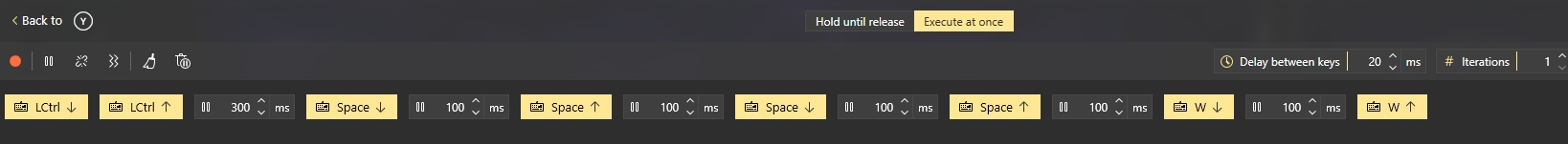

Name:	Screenshot 2022-11-05 144033.png
                This should be around the correct timings needed for the trick. The 500ms delay between the final W press and release can be adjusted to preference; 500 is pretty good for ensuring that you can reconnect to the wall even on a fairly large forward-sloped wall.
