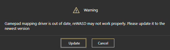

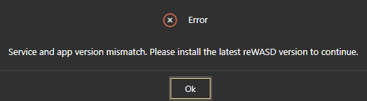

              I do get the notification to reboot the pc after installation. When I boot it back up I get this:
Name:	Screenshot 2022-12-14 211733.png
Name:	Screenshot 2022-12-14 211837.png

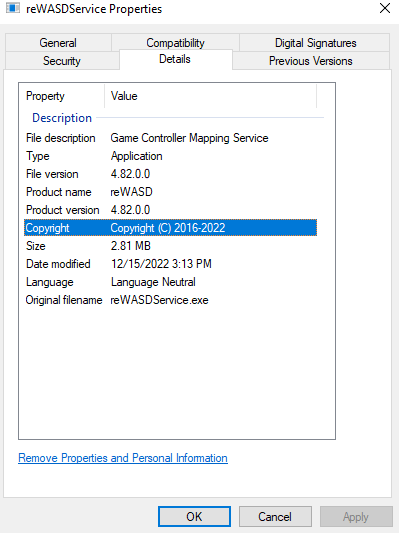

                Please open [Services], find the [Gamepad Controller Mapping Service], and stop it manually. After that, go to C:\Program Files\reWASD\ and delete all the files and reinstall the app.
                If this does not help, then find C:\Program Files\reWASD\reWASDService.exe, right-click on it, select Properties → Details and send us a screenshot of what you see.
                • #23
                  This did not work. I'm getting the same errors. Here is the screenshot.

                            I get the gamepad mapping driver is out of date. When I click yes to update it it gives me the version update mismatch. It does it every time I reboot and sometimes pops back up when using rewasd which crashes it.
