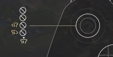

    Hello.
    Apply Mute to all stick directions, and then manually add mappings for left stick deflection to the left and right respectively, without adding mappings for the Y axis.​

        Hello! When Mute is applied to a stick, its native input is muted. If no other mappings have been applied to it, then it will not be recognized.
        If mappings are applied, but it is still not recognized, then please send a screenshot of your config and record the problem on video if possible.​​
