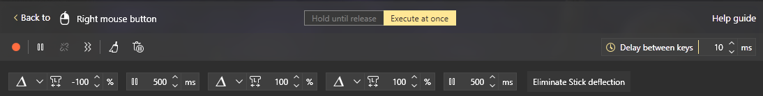

                • #23
                  You should try this Combo instead. It will add to the current stick position instead of trying to override it.
                  The last node will be added once you select "Yes" when leaving the Combo editor.
                  You might also want to minimize the [Turbo] value, as the pauses in the Combo would be the ones to set the intervals.

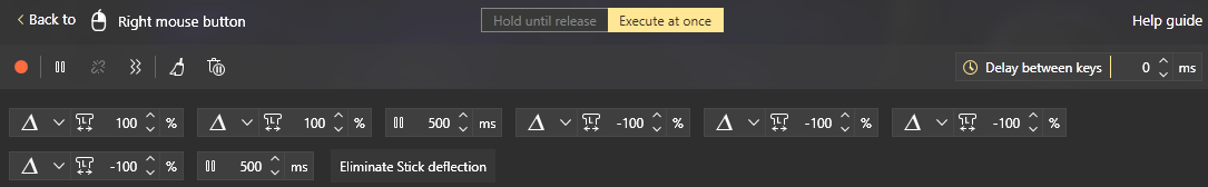

                            • #29
                              Ensure your controller and mouse are in the same group in reWASD. And select that group.
                              Check if the Xbox 360 or One is selected as a virtual controller for your config. A corresponding icon will be shown at the bottom left corner.
                              Then set [Turbo] value for your [RMB] to 1 and change the [Combo] to this:
                              Once the config is applied, a virtual Xbox 360/One controller will be created and your physical controller will be hidden. Windows [joy.cpl] tool must show only one controller in the list.
                              Test the [Combo] either with Windows [joy.cpl] tool (Preferences) or at [Gamepad Tester] site.
                              If the game would ignore inputs from this virtual controller - try using another one.
