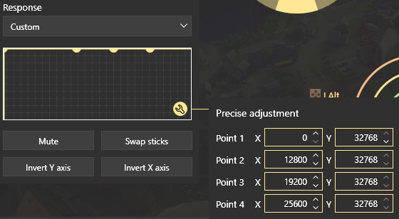

    What's the Highest/quickest response you can set the analogs to when you have to adjust the graph.
    This graph: https://ibb.co/M6Xs8n2
    Not sure I understand your question...
    Instant 100% deflection on any movement?

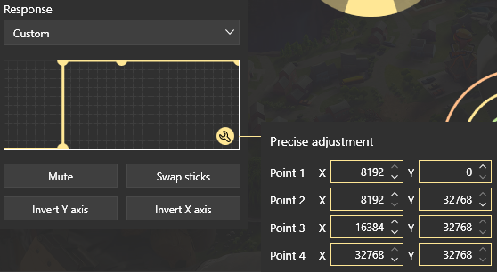

      Sorry if I was unclear but I think so yes?
      So if I used that set up, will it instantly move my character in any position I move my left analog in?
        Yes. Though you might need to change the values of points 1 and 2 to account for a deadzone, as otherwise, the stick might always stay at 100% deflection.
