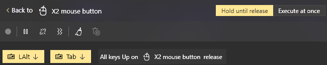

    Hello, is it possible to add the shortcut (hold alt and switch by pressing tab) to one button in my mouse rather than using 2 buttons, tried the "combo" option Hold until release but didn't work. Thanks
    Hi. [ALT] must be first in the [Combo] to work properly.
      Yes its first but it didn't work
      LAlt down , Tab down , Tab up , LAlt up
        Your [Combo] should look like this:

        And you would have to hold the remapped button for a bit, for it to work.

          Thanks Shion, this is the same macro i was using before rewasd but the problem is that it moves very quickly.
            You can try lowering the key repeat rate at [Virtual input device settings].
              Tried that but still didn't work, i will map it to my azeron and i will use 2 buttons same as the keyboard. Thanks for the help appreciate it.
