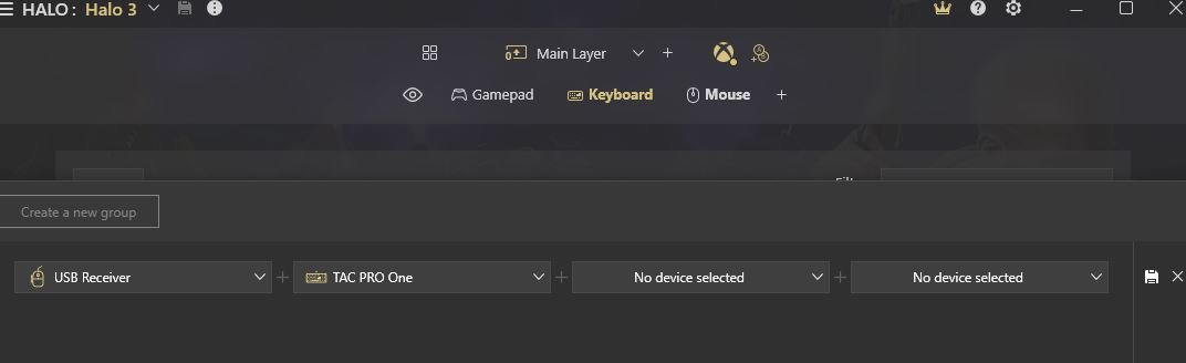

    It may be a chance that something is wrong with the device initialization. Please show me your group, like here.​
      So everytime I move my mouse even though it is remapped to the right stick. In the game on the bottom right I can see the xbox buttons disappear and it displays keys.

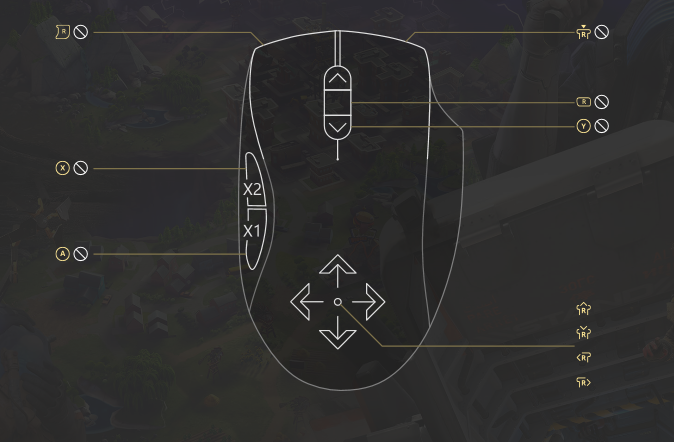

        These are the buttons I have mapped to the mouse.

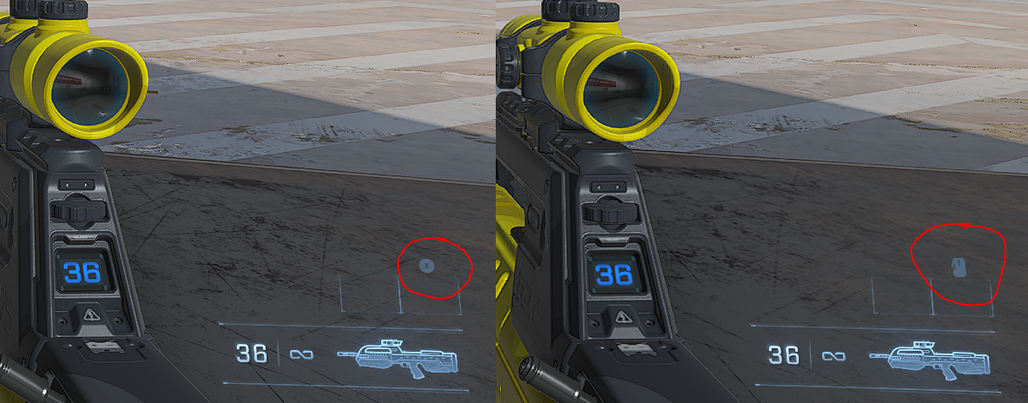

          On the left you can see an xbox button indicating I am using my keyboard successfully with reWASD, on the right as soon as I move my mouse the mouse icon shows up indicating I am using a mouse. However if I do not move my mouse and simply fire with the right click it shows and xbox button. So I'd say this is half working. I'm not sure how to diagnose this.​
            All and all I believe when I move the mouse and as that Icon shows up I am losing the aim assist, which is my concern.

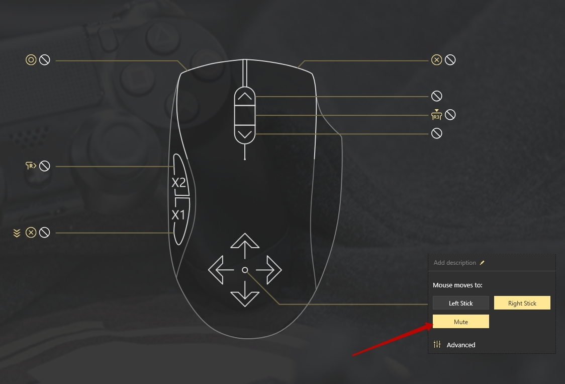

              It looks like the game is experiencing input switching due to the fact that you did not apply Mute to mouse movements.
              Apply Mute to emulate only gamepad input.​
                Click image for larger version  Name:	image.png Views:	0 Size:	433.1 KB ID:	235112​

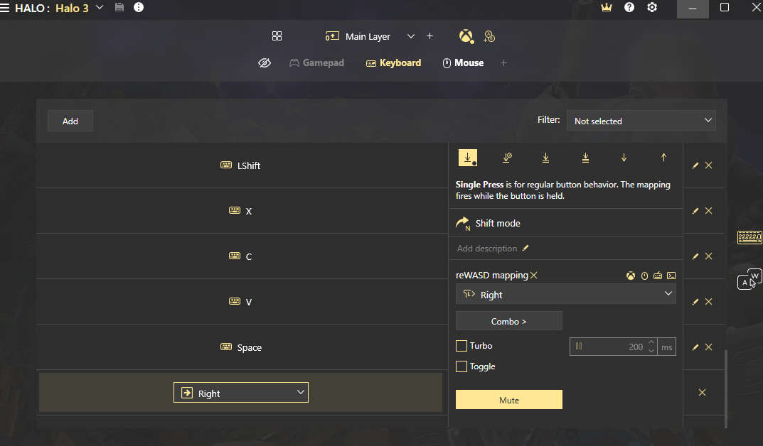

                By golly that was it! Thank you so much! one last thing, I have the right arrow mapped to left stick pushed right and I can walk all directions accept for right.
                  If you meant “except to the right”, then it looks like the problem is still the same. You need to have all the buttons you use in the game remapped in reWASD to the virtual gamepad buttons. It doesn't seem to be the case in your situation. And when you move in all directions, the game will detect it as a keyboard gameplay, but because your right arrow is Muted, its native input is not being read.
                  I would recommend you to try some ready-made config for Halo from our community, in which all controls are remapped to controller.​
