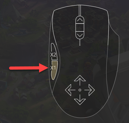

          Thanks again! I managed to try it but it didn't work. I mean I hold the mouse button but everything works like normal.
            In the config provided by 1ncorrect, this (X1) button is set as a Shift#3 layer switch. You have to hold it for WASD keys to act as D-Pad buttons.

            Please make sure the mouse's native software does not remap it. Or set the resulting key as a Shift#3 switch in the [Additional mouse buttons] list.
              Yes, I hold it and it doesn't work, in fact it meeles and set a mark point at the same time. Do I need to purchase a license for it to work? I'm pretty sure I bought all the licenses I need
                According to the config, that button is also remapped to the [R3]. Otherwise, the config works as it should - when [X1] is held, the WASD are remapped to D-Pad buttons.
                Check your group of devices, as it is possible that you have the wrong mouse device in it or your mouse is initialized as a keyboard in reWASD. Check case #24 here for details.
                  You are right, thank you very much, it said keyboard. Evrytime I tried to edit the file it took me to the rapid fire license thing. Now that I changed it to my mouse is working Great!
                  Now I'm having trouble droping things because you have to use R3 and that button is binded to R3 too, is it posible to change it to the X2 button on my mouse instead of X1
                    Yes, it is possible:
                    • [X2] button should be remapped to [Square] in that config, so change it to [R3].
                    • Then select the [X1] button, click [Shift mode], and remove the [R3] mapping with the [X].
