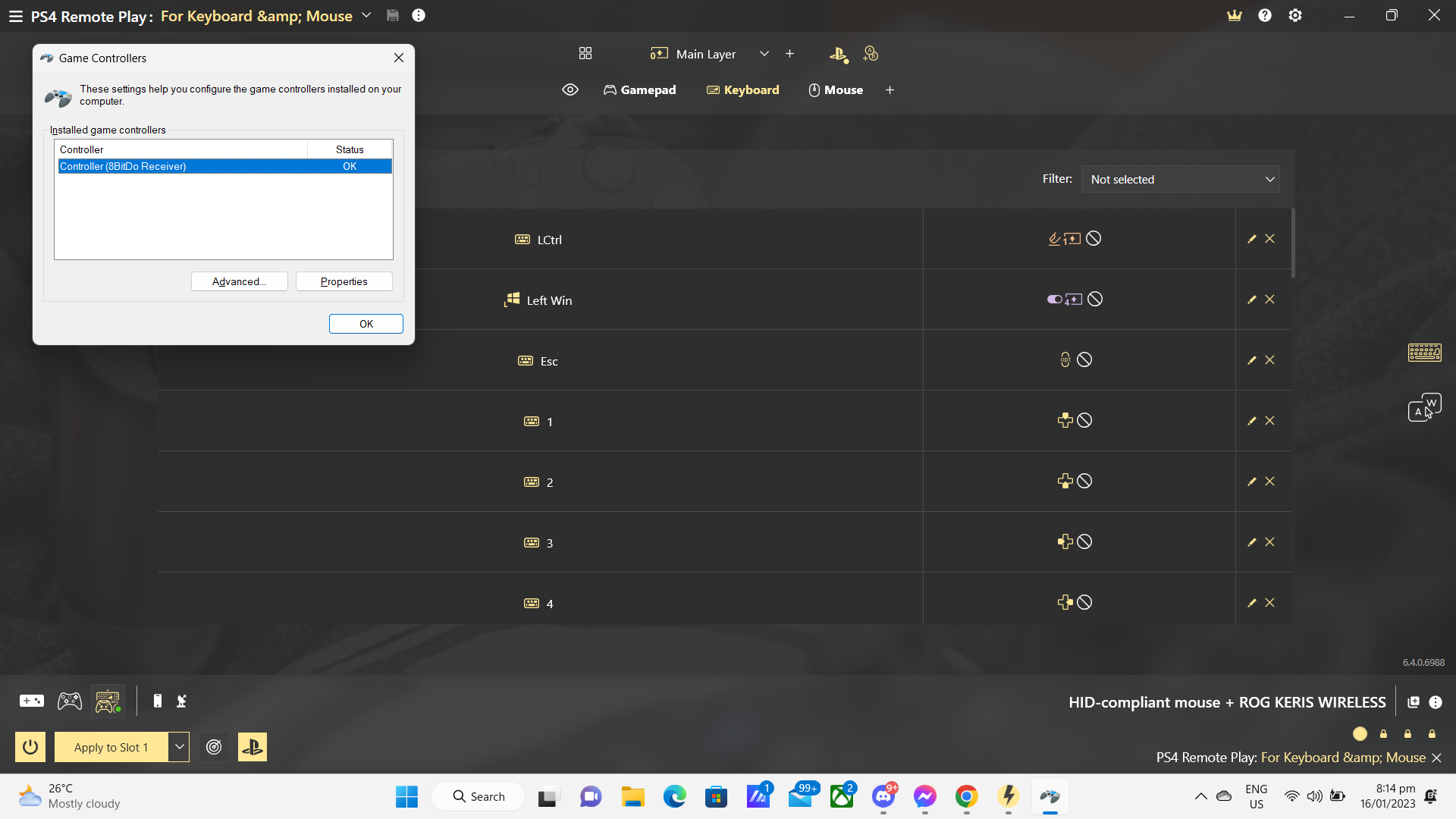

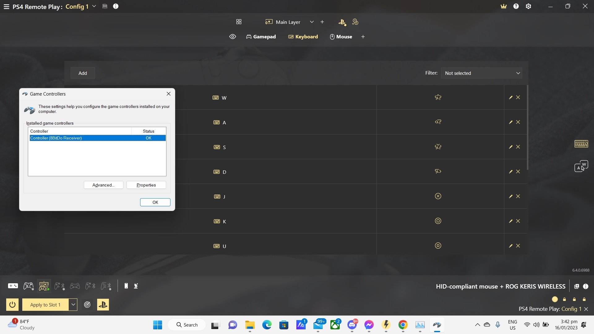

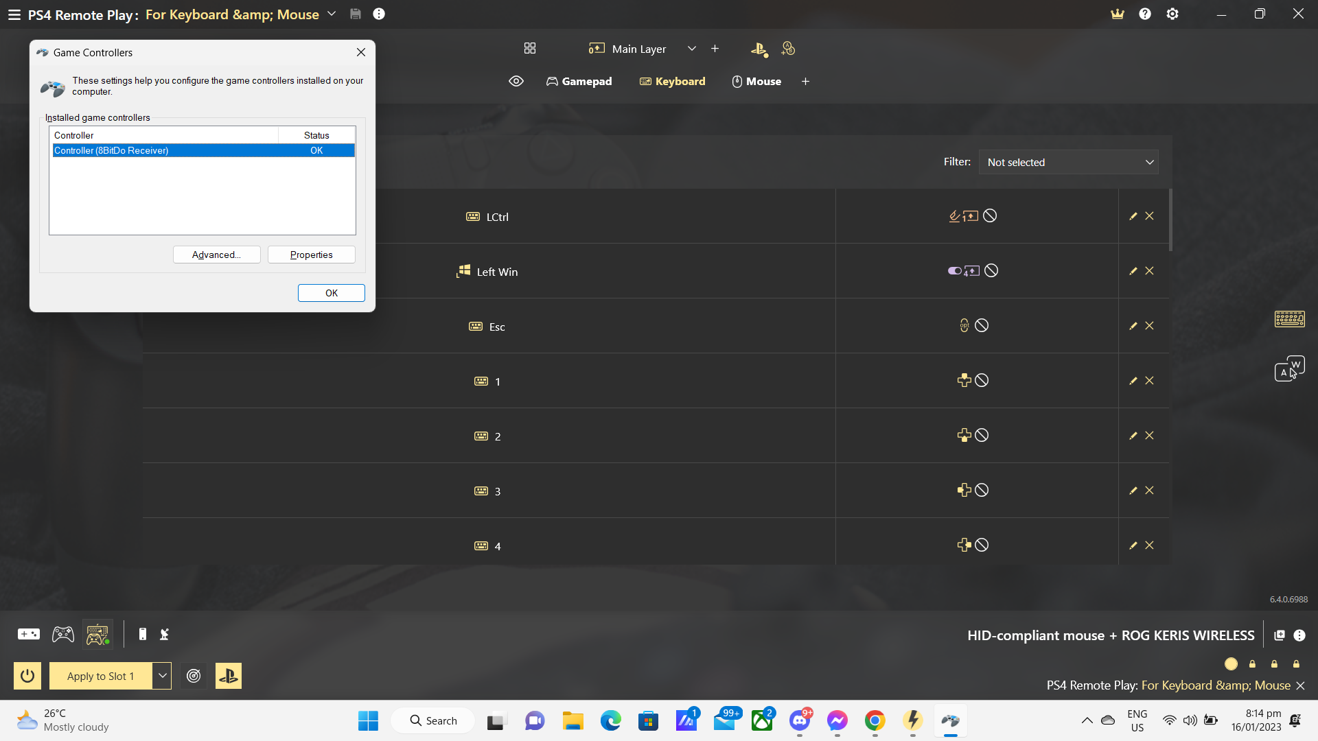

    Hi, As the title says, my keyboard and mouse group doesn't seem to be detected as a controller when I press the Apply button. I want to use my keyboard and mouse to play PS4 Remote Play on PC and I can't get it to work, any help will be appreciated.

      Hi. Thank you for replying. I tried clearing the data and applying your config but the system still won't recognize the KB/mouse as a DS4. By the way, only the virtual DS4 doesn't work, other virtual controller type works fine when I switch to them. (even the DS3 works fine)

        Do you mean that the controller appears in joy.cpl if you choose Xbox or DS3?
          Yes. And upon checking, it seems this is also the case if I connect another actual controller {like procon or xbox 360 controller) then switch them into virtual DS4 in which they can't be recognized by the system.
            Most likely you have some 3rd party software installed then. And it hides DS4 devices from system. Look for HIDGuard or similar software and uninstall it.
              I tried resetting my Windows to factory settings and still can't get the virtual DS4 to be recognized by my system. I connected an actual DS4 and it showed up in joy.cpl but not the virtual DS4.
                It looks like you still have some 3rd party software or controller driver installed on your PC, which hides our virtual controller from the system. Remappers like ds4windows and remote control apps like Parsec are known to do that (both use Vigem to emulate an X-input controller and HidHide/HidGuardian to hide the "original" DS4 controller). Uninstalling those apps and drivers should fix the issue.
                  I have fresh windows reinstalled so I don't have unnecessary drivers installed. Maybe I have a missing driver instead?
