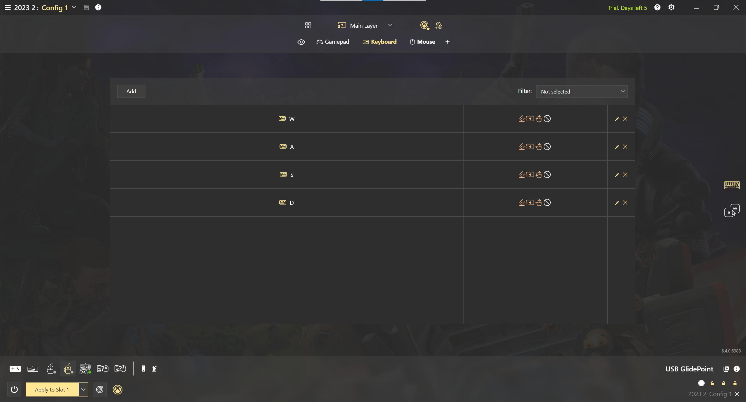

    Hello everyone , I would like to be able to use the wasd buttons with the mouse . I have tried to set them like this but nothing works . Can you help me please ?

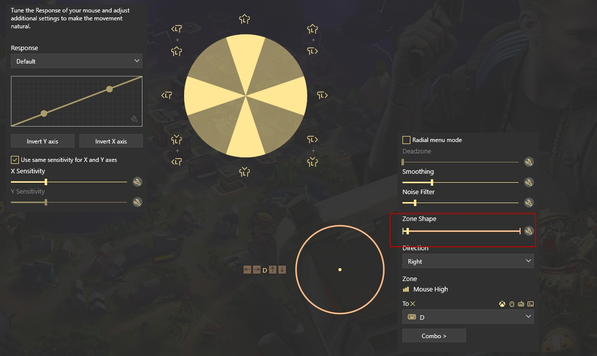

      It is exactly what I was looking for. I set it like this but something is not working . Can you tell me where I am wrong please ?
      I have activated the profile but when I go into a game nothing seems to change.

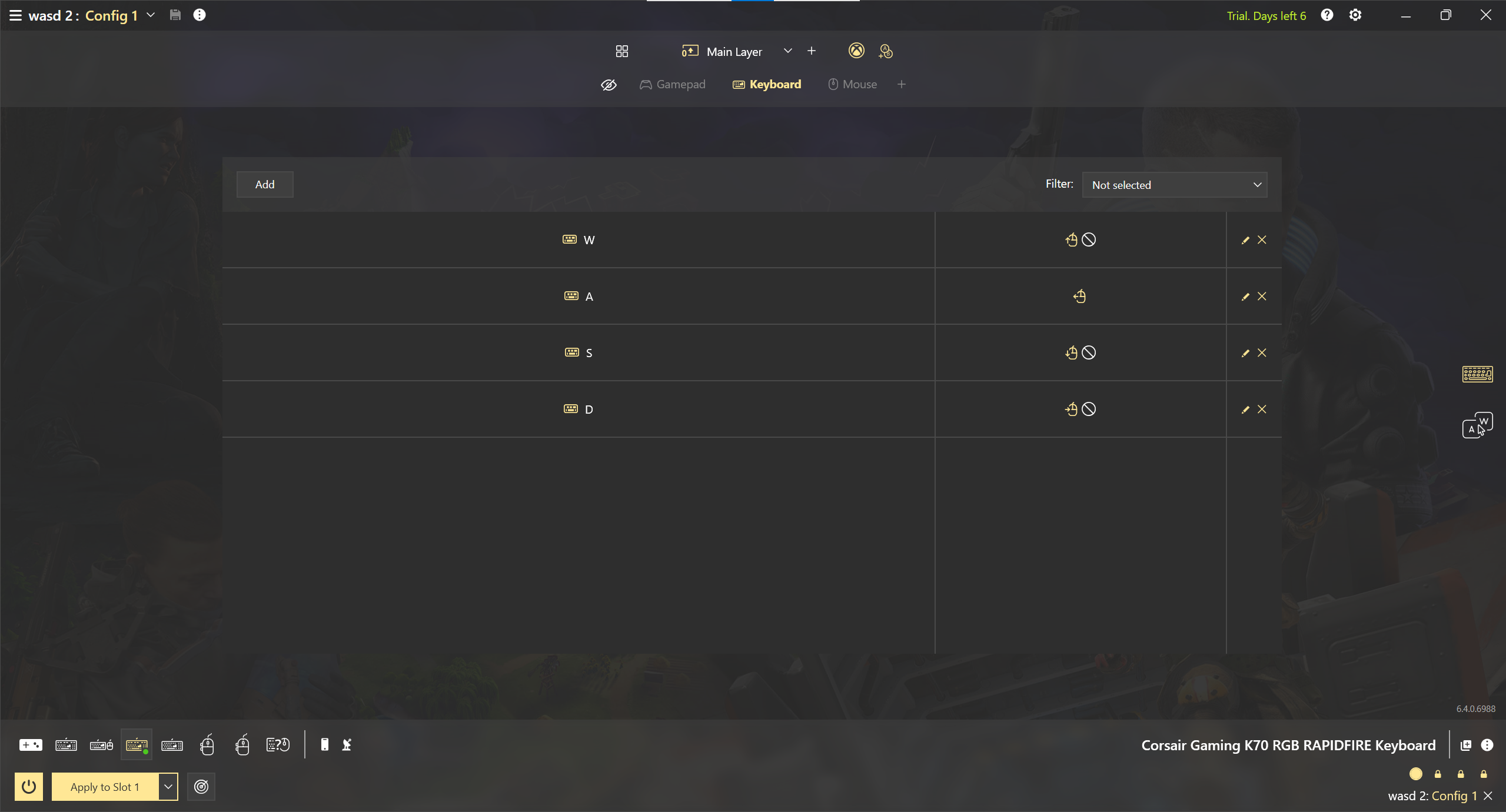

          Hi thanks again for your reply and help . I can see in a text document the wasd letters, but they are generated almost randomly. They do not respond well to mouse movement. I probably did something wrong in the steps .Can you see if I did the last step right (Jump to hold) please ?

            You are again trying to configure these buttons in the keyboard subconfig. It won't work. If you want to emulate WASD physically using a mouse, then mappings must be created in the mouse subconfig.

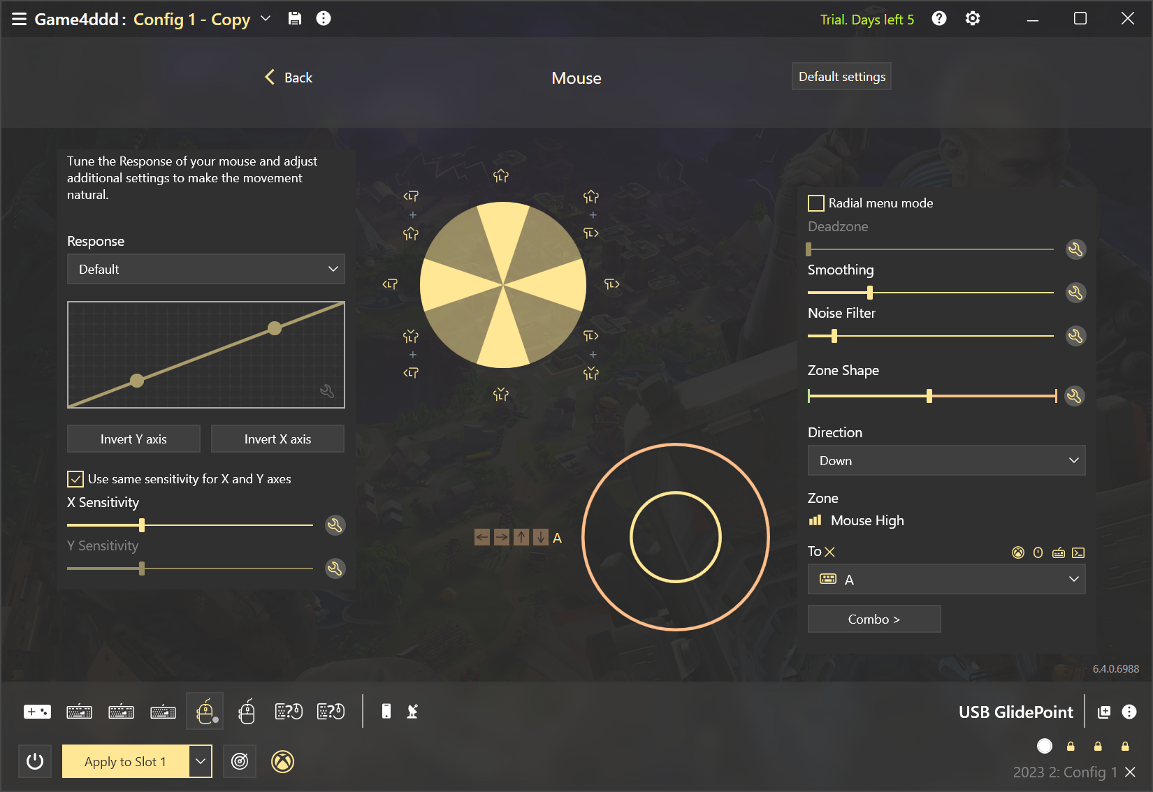

            The ideal behavior of WASD on the mouse will not be, as this is not a ready-made mapping, but rather a workaround. In the screenshots you sent, this workaround is implemented correctly, however I would recommend stretching the High mouse zone so that the WASD input is not so random when you move the mouse.​
