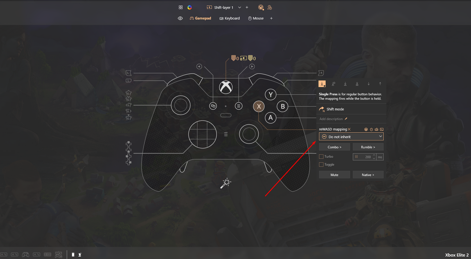

        To avoid this kind of behavior, all you need to do is to add [Do not inherit] mapping to the in Layer 1. It helps to stop reproducing the mapping from the main layer
          This worked. Thank you. Would it make sense to have a second layer default to "not inheriting" a previous layer?
            Only if you need it. Based on your config, you don't have other mapping to use this option
            However, If you don’t want the button inside the Shift layer to reproduce as the mapping from Main, pick Do not inherit option from the reWASD mapping. this way, when that Shift layer is active, the not-inheriting key will normally work, as if no mappings are applied to it.​
