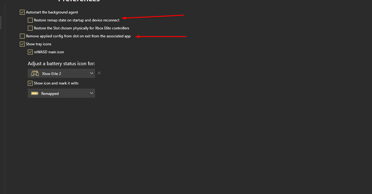

    Please try to uncheck both of these options
      When I uncheck lower one, the problem is even bigger, I have 6 different profiles and almost 20 games which use reWASD via associated app, and then I have 200-300 games which don't need reWASD. Now when I uncheck that -> the last used config stays on -> which I don't want to in the next game. So I must open reWASD manually and turn that last config off before starting next game. So I put that lower one back. But not sure what that upper one do, let see.
        Okay, when that upper one is unchecked it might solve this problem. I am not sure because this is happening only sometimes, and sometimes when I am using 6-8 controllers at the same time.
          The top option would restore the state of devices they had at the moment of PC shutdown/restart. So if you have some configs applied when you turned your PC off, they will be reapplied on the next Windows logon.
          [Autodetect] restores the state of the controller to the one it had before [Autodetect] was triggered. So if some config were reapplied on logon, [Autodetect] would also restore it when you close or leave the associated app.

              I tried this, only uncheck this "restore remap state on startup and device reconnect" and keep that checked "remove applied config from slot on exit from the associated app" - because I need that. Without that I must use reWASD all the 10x more manually than now.
              But I test that upper one unchecked and it didn't solve the problem. The [Autodetect] when existing the associated app still triggers back the previous one "manual-config" which I already turned off once. So at local party games, when I will use once reWASD config in manual state (2 games need it) - I have to come back to turn that off after every single game which using autoconfig [Autodetect]. Only restart pc between these games will stop reWASD doing this...

                >Is this "restore remap state on startup and device reconnect" the reason why [Autodetect] is triggered doing so? So if I uncheck that -> it stop doing that. Or is [Autodetect] triggered to doing this anyway - without option to turn "trigger" off.
                I don't understand the question. This option, when enabled, will restore the previous state of the device when you leave the associated app. With it disabled, reWASD would do nothing an keep the current config applied.
                >Could it be possible to add some feature/option for settings to avoid this kind of behavior?
                We'll consider adding this option. For now, instead of using the [Power] button to disable remap, you could use the [X] icon at the bottom right corner of reWASD where the slots are shown. This will remove the config from the slot, so it won't be restored by the [Autodetect] later.
