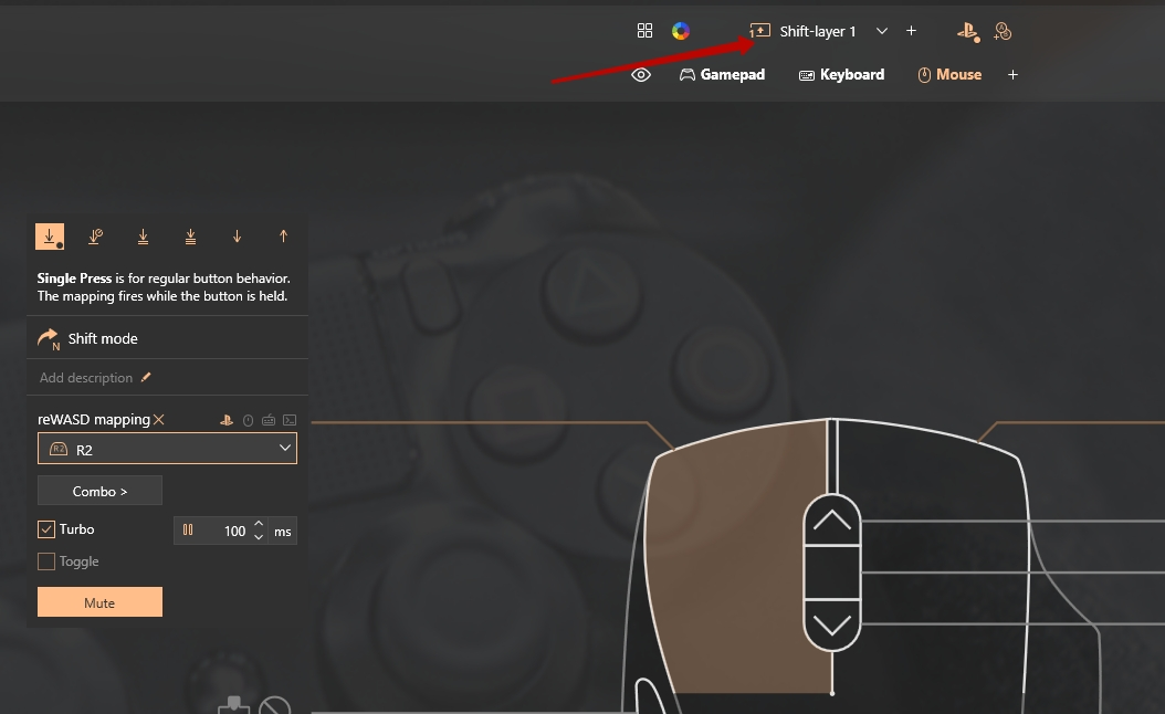

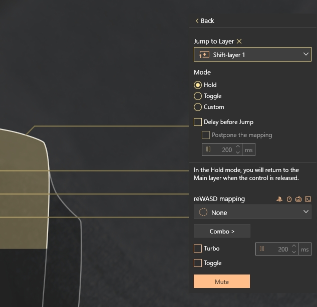

    reWASD has a Shift mode feature. This is a feature that permits creating up to 10 overlays with mappings that differ from the Main layer.
    Thus, you can assign the right mouse button as a button to jump to another layer (eg Shift 1) in Hold mode.
    And then in layer 1 make the left mouse click work as fire button with Turbo.
ID:	236313Click image for larger version
