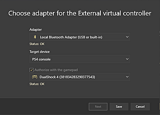

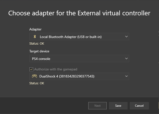

    Hello, please help, the adapter for an external gamepad on PS4 via USB bluetooth adapter ASUS BT400 does not work properly. Everything works for exactly 8 minutes, and then stops responding. I tried to change the REWASD versions, nothing helps.

          If it stops after 8 minutes it most likely means you have problem with authentication controller (real DS4 you have connected in same profile).
            ​Yes, in the profile. This happens cyclically for exactly 8 minutes, and the PS4 does not accept repeated clicks. The Bluetooth connection remains active.

              As DevX mentioned earlier, the problem is probably in your controller.
                We checked the logs and did not see any errors from your DS4 (authentication) controller. It takes a bit longer to reply though, but we think this should not cause any problems. Can you specify your DS4 model and how it is connected? We have also rechecked this on our side and did not experience any problems.
                  Yes, you're right, I borrowed a gamepad from a friend, and everything works fine. Thank you. I'll buy a new gamepad.
