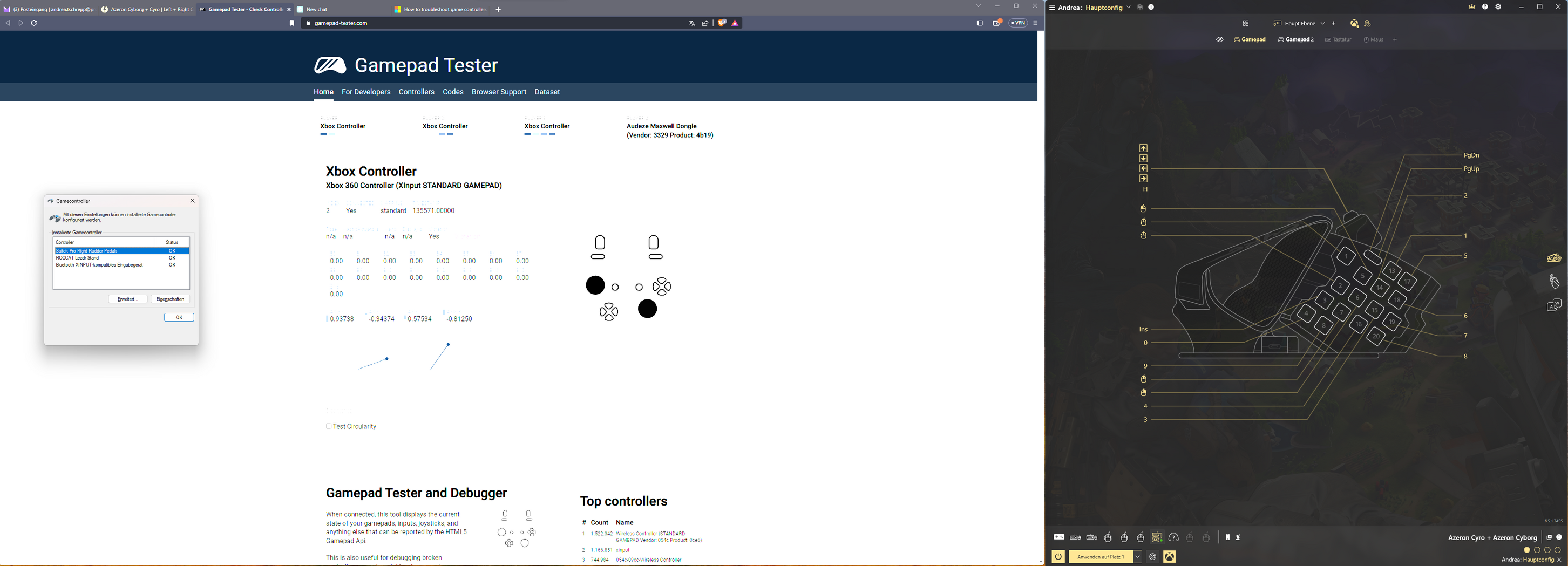

          Hi, both sticks work but the left one (cyborg) is showing movement as player 1 and player 3 on that site, while the right stick (cyro) is showing function on player 2 and player 3. dont know if that is normal...
            this is the screenshoted behavior from that site. Only player 4 shows both sticks working...Click image for larger version

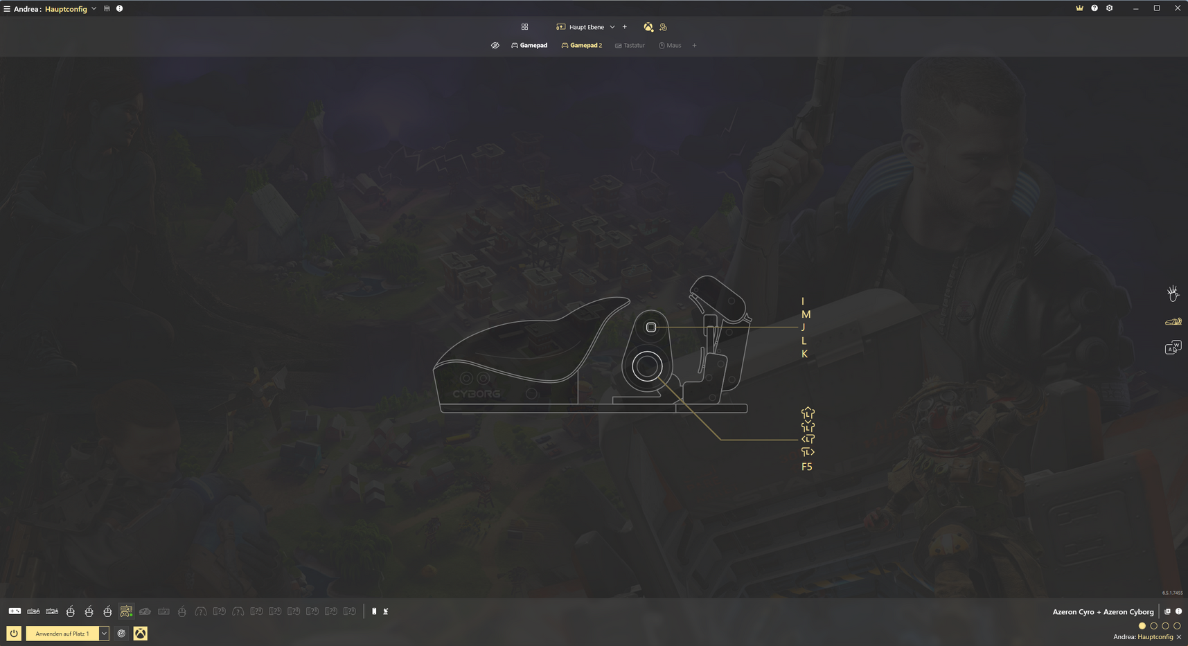

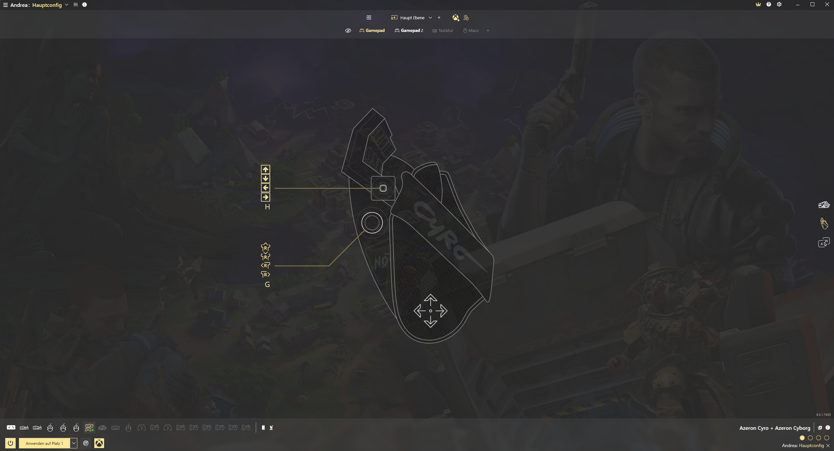

              Could you send screenshots of the full reWASD window with your device configurations at the time you apply the config?
              Thanks in advance.​
                Thanks for the support and here you go. If you need the screenshot of the popup that usually is generated in the lower right corner, cannot manage to trigger it today. is there a trick to it? It usually always came up once I clicked apply. today it does not seem to want to. One only gets generated when I remove the overlay application, not when I apply it.

                            The result in Gamepad Tester suggests that you haven't applied the config before the test.
                            Make sure to apply the config first, then check if [joy.cpl] shows only one device in the list, then test the sticks.
                            You should do the same for the games: apply the config first, then start the Steam/game.
                              Hi Shion, I am sorry to say you are mistaken. I definitely always apply the config before starting the game and tried multiple times to apply, disable and reapply the config multiple times. The result of the tester does not change, neither the behavior in game. I will show you this screenshot as proof, and gratefully await any further suggestions from your part. Click image for larger version
