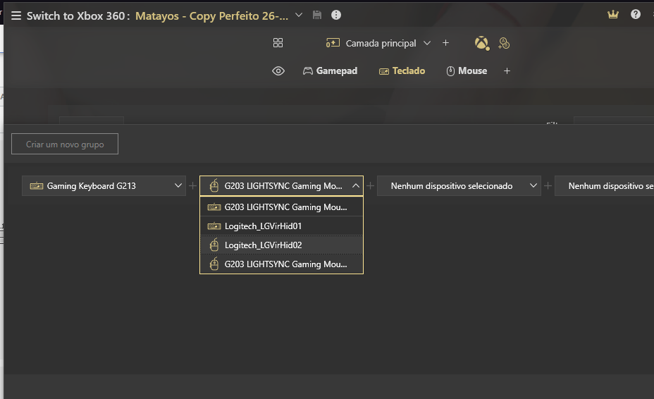

      I don't know if I understand, would this be options?. I would need to add which ones?Click image for larger version  Name:	Sem título.png Views:	0 Size:	51.0 KB ID:	236855
        Both, if you are using mouse and keyboard inputs in your macro. Or only Logitech_LGVirHid01 if you are only using keyboard inputs.

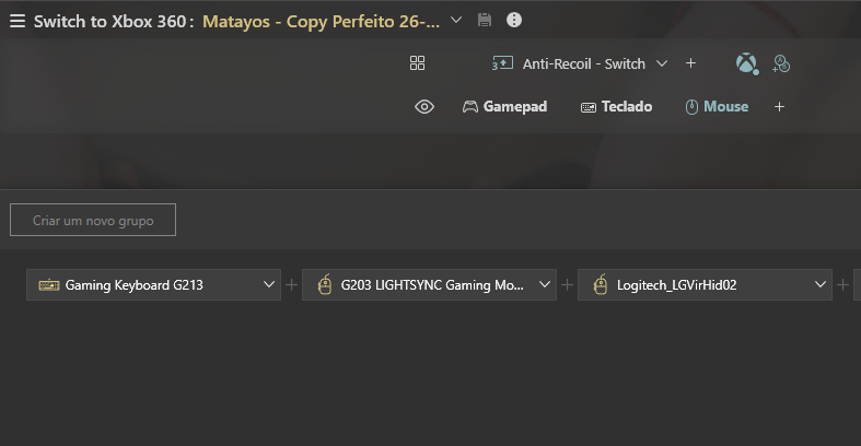

          So I set it up this way. But when I press the right+left button to activate the Ghub macro, it doesn't work with ReWASD activated, only when I deactivate it. Do you know how I can proceed? Did I configure something wrong?

            Your screenshots don't provide enough information.
            To understand your setup, we will need a screenshot of your macro made in G Hub and a button it is mapped to, and a config file you are using in reWASD.

                Your config has all mouse buttons muted except the middle one, meaning that its native input would not be passed to the system, and G Hub won't "notice" it to trigger the macro.
                Since the "aimbot lmao" mapping requires both the middle and left mouse buttons to be pressed - it won't work. The same goes for "Crouch Cancel" and "Rapid Fire", as side buttons are muted.
                [J] key doesn't seem to be remapped to anything in the config. Unless the game allows double input, it won't do anything in the game.
                [Q] is remapped to the left bumper, so it should get triggered a few times when the 5th mouse button is clicked, and the [NumLock] is on.
                To remap inputs from G Hub, you would need to add both virtual Logitech devices to the group. Though to trigger the macro commands, you would need to keep the related mouse buttons unmuted, which would result in double inputs, making this setup somehow useless.
