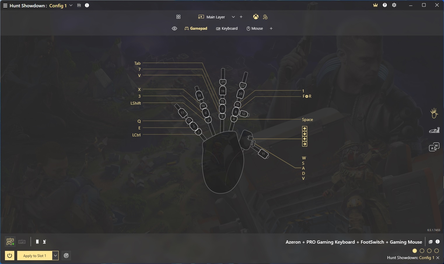

    Please send a screenshot of the full reWASD window with your configuration on it
ID:	236971Attached the screenshot.

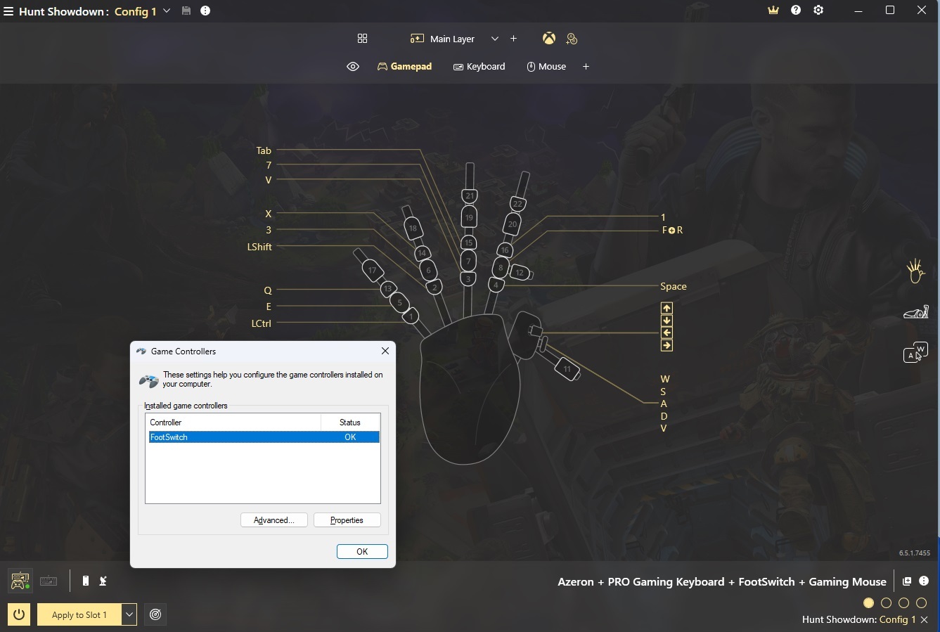

        Apply the config and type joy.cpl in Windows search.
        If there is some kind of Azeron controller or 360 controller, then try to find it in the device manager and disable it manually.​

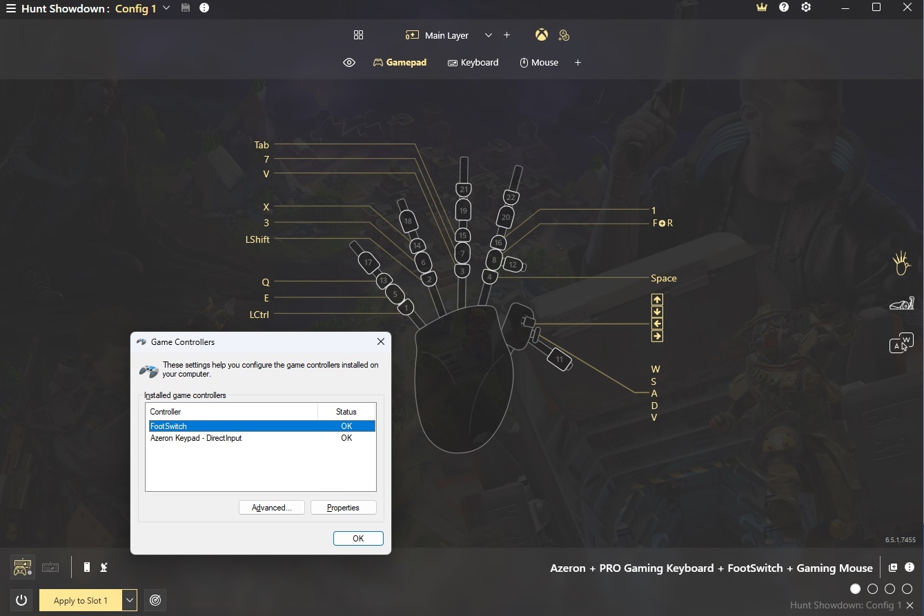

          When the config is NOT applied, there is Azeron Keypad - Direct Input in Game Controllers
          When the config IS applied, the Azeron is no longer there.

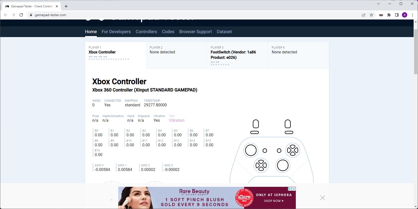

            2. Apply the config and check if the gamepad tester sees this "phantom" Xbox controller and shows its input?​
              Yes, I have steam running. On gamepad tester, when I apply the config and move the thumbstick it does show up.
                It appears to be input from a native Azeron 360.
                Try disabling controller support in Steam settings. If this does not help, then you need to manually disable this device in Device Manager.​
                  The gamepad input on gamepad-tester.com only registers when the reWASD config is applied.
                  When the reWASD config is not applied there is a different entry on gamepad-tester.com called Azeron Keypad - DirectInput (Vendor: 16d0 Product: 0f3f) --and the Xbox Controller input that appeared prior stops responding.
