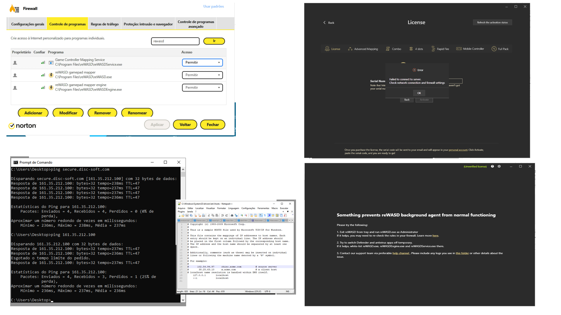

    Hello, I buy rewasd but I can't use or activate it! Access the forums and followed all tutorials but none resolved. my firewall is not blocking it, I did a ping test and it's ok, my hosts file is ok, i try use VPN. I made several attempts but I can't use or activate the application. how can i get help?

    "Unverified License" error is shown when reWASD GUI (reWASD.exe) is for some reason unable to communicate with either our service (reWASDService.exe, Game Controller Mapping Service) or our Engine process (reWASDEngine.exe).
    Please make sure all mentioned processes and services are running and not blocked from access to the Lookback Interface (127.0.0.1), Local Network, and the Internet.
    To avoid 3rd party interference, allow Internet access for all three in your Firewall software and add them to exclusions in your Anti-Virus/Protection software.
    If none of our suggestions would help, try to do a clean reinstall of the reWASD app:

      I did this procedure but still with the same error. I uninstalled the antivirus, reinstalled it, added the ports and it still didn't solve it. tried this one
      1. Run the ping secure.disc-soft.com command. It should resolve as 161.35.212.100, and all packets must reach their destination.
      2. Open the https://secure.disc-soft.com link in a Chrome-based browser. If everything is normal, it should redirect you to our homepage. If it does not, send us a screenshot of the page or error you see instead.
      ​and not solve...

          There is something on your PC that is blocking access to our service. Unfortunately, we cannot determine on our end which application on your PC is doing this.
          Please, check the Windows Security → App&browser control → Potentially unwanted app blocking option and turn it off.
          If you are using Windows Firewall, ensure all reWASD rules are enabled for all network types.
          If you use third-party anti-virus or protection software, try adding all reWASD executables to the exclusions or trusted apps list.
          If you use an Eero Security service on your router, please allow the secure.disc-soft.com domain in its settings or disable the service.
          If your PC cannot make a stable connection to our server, we suggest using a VPN service or contacting your Internet provider for further assistance.​
