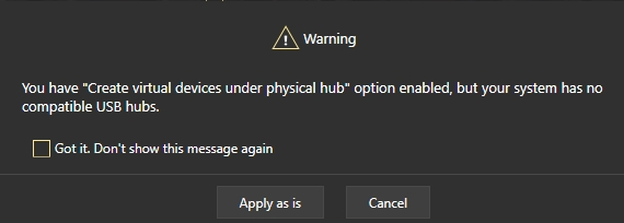

        Hi. Did you get a similar warning when you applied the config for the first time?​

          hmm i dont think so. i got one about having to restart, but it didnt really do anything after i did.

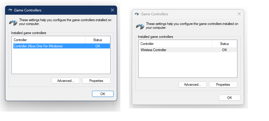

            Could you please show us what device is detected in joy.cpl before and after you apply your config?
            In order to open joy.cpl follows these steps:
            1. Press Win+R
            2. In the opened window, enter joy.cpl and press "Ok"

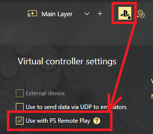

            Also, could you show if this is turned on in your config?

              thanks for replying. i do indeed have tha box checked. and this is what i see in joy.cpl before and after i select the remote play 2023 config

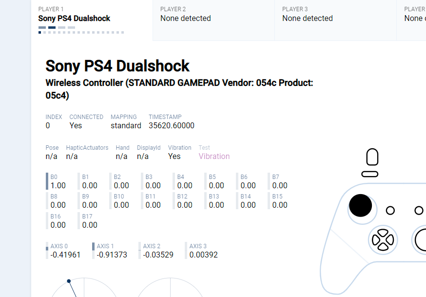

                1. Apply the config and check if it works on the gamepad tester. It should identify itself as Sony PS4 DualShock.
                2. Make sure your system has a USB 2.0 Hub. This can be checked through Device Manager.​
                  it does detect it as a ds4 on the site, but just not in the remote app, like it used to. like i mentioned in the op, there are reports that a recent change to the app forbids all controller emulation, which would appear to be happening to me. thus im curious if there is anyone else out there who is successfully using the ps5 remote app with their xbox controller

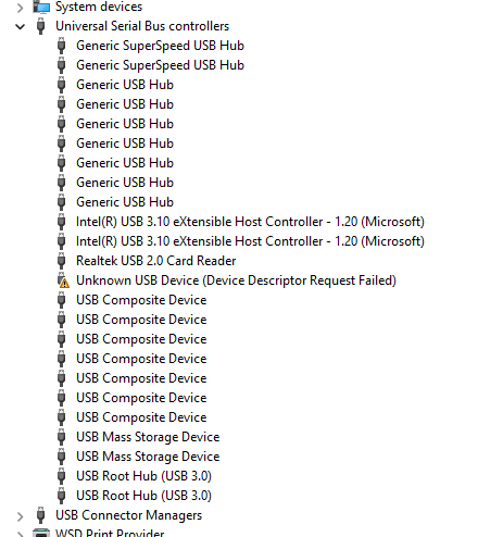

                        In the correspondence by mail, you indicated a different hub.
                        Could you send a screenshot of what this hub looks like in device manager?​
                          thats correct, i purchased another one earlier this week just to be sure the one i had wasnt the problem.
                          im not sure what device is my new hub, even if i unplug and replug, i dont see it, unless you are able to
