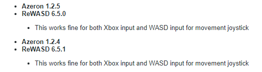

            • Azeron 1.2.5
            • ReWASD 6.5.0
              • This works fine for both Xbox input and WASD input for movement joystick
            • Azeron 1.2.4
            • ReWASD 6.5.1
            So it looks like there is some sort of conflict with Azeron 1.2.5 and ReWASD 6.5.1 - but only for profiles that map WASD for the movement joystick.

                Alright last update for now I guess, the bug started to happen again even with Azeron 1.2.5 and ReWASD 6.5.0.
                I updated everything (Azeron 1.2.5 and ReWASD 6.5.1) and it looks like the only way I can make the issue go away is to select an Xbox input profile, move the joy stick around for a second. Then switch to a WASD movement profile.
