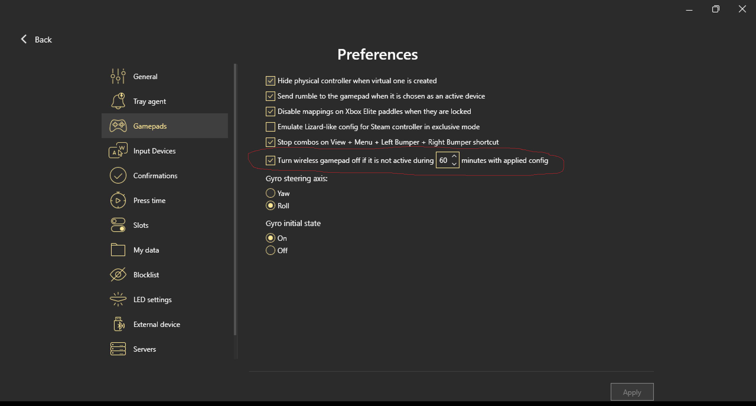

    Hello, is there anyway to change the idle shutoff of the Elite series 2 controller? I have tried changing the setting highlighted in the attached photo, but didn't seem to work.

    I have tested on 6.4.0.6988 and 6.5.1.7619 versions(Xbox Elite 2 with official dongle), and it works.
    Please set 1 min in this field and collect some log files for us.
    So, once set up for 1 minute, you need to click on Apply and wait 1 minute, then stop the log.
    Please also provide us with your Windows OS and xbox elite firmware

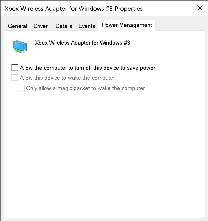

        However, you can try to do the following:
        Open [Device Manager], set [View] to [Devices by Container] and find your adapter/controller. Then check all devices within for [Power Management] tab. If it exists, uncheck the [Allow the computer to turn off this device to save power] option.
          There is no option to add unlimited time there
          I have that tried that awhile ago and doesn't seem to work.

              After a little testing the timer on rewasd works to shut off the gamepad if set to 1 min, but not anything longer then the default 10 mins or so. Hopefully this can be solved, also add unlimited time as a option. I place controller on charging dock when I put the controller down, so unlimited would be nice.
