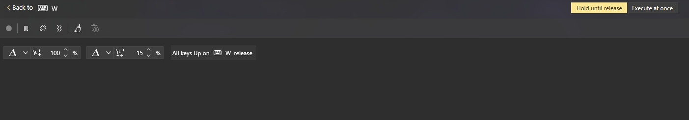

            In theory, you can "rotate the axes" yourself. If the angles look a bit odd in the game, you can map W,A,S and D as combo of two stick directions in Hold until release mode, which will shift the direction a bit.
            Here is an example of such a combo for W:

            But it's still just a workaround.​
