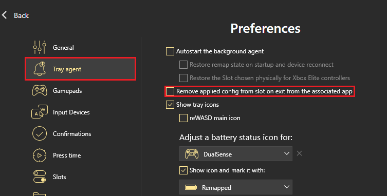

      * [Preference]->[Tray Agent]->[Remove applied config from slot on exit from associated app] turn OFF

        Hi. Unfortunately, we don't quite understand why you manually clean the slot when you can use the "Remove applied config from the slot on exit from the associated app" setting, which you can find in Preferences in the Tray agent section.
