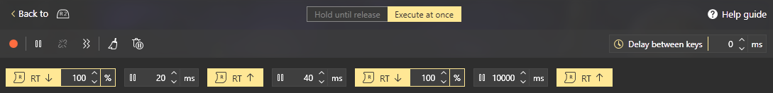

    You can [Mute] and remap your triggers to a [Combo] similar to this and enable [Turbo] flag for it on that shift layer:
    Click image for larger version  Name:	Untitled.png Views:	0 Size:	22.8 KB ID:	237993
    This [Combo] will tap and hold the trigger for 10 seconds or until you release it. Adjust the first two pause nodes for "first tap hold" and "pause after tap" intervals.
    Note: as a result, you will lose its analog range while on that layer.
