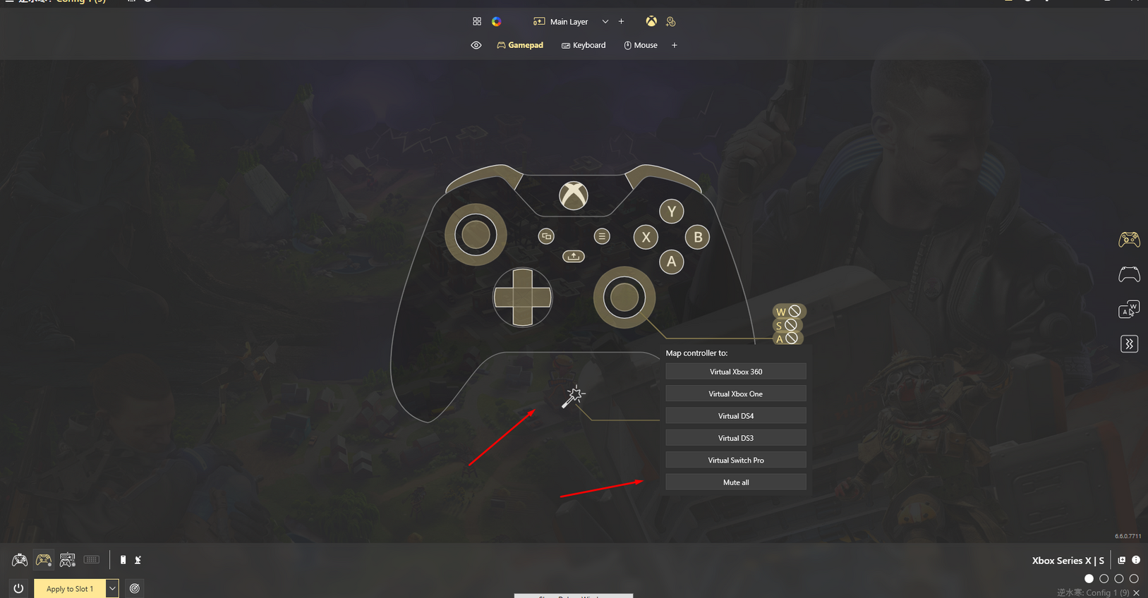

    I have a disability that I found a workaround for in some FPS games. I cant use my right very much, so I use a left handed mouse to aim. I also cant use the keyboard with my right but can use a controller right stick.
    I remapped the controller to move was with the right stick. There are some games that it doesn't work with, however. It does this:
    I use the right stick for wasd, but it also moves the cursor. So its acting as the mouse and was.
    Some games that don't have controller support work fine. But I want to play other games and don't want to risk buying a game that I then cant play.
    Can anyone help?

        How do I "mute" the right controller stick from moving and aiming at the same time? I only want to move.
        Side note-certain games also don't let me remap because as soon as it registers controller, it makes me use the controller support default buttons. I just need help lol

          To keep only one input you can add the mapping to the right stick like on my screenshot.

          You need to click on the stick, choose WASD mapping, and Mute the native stick input using Mute option. Moreover, I left a link to Mute feature in my last post. You can find more info here as well.
          Once you add Mute option, the game will see only WASD mapping while you use the right stick
          In order to Mute all gamepad inputs, click here:
            Thanks for the help.
            it isn’t working. Is there any way this is because I’m using a switch pro controller?
              There is a possibility that Steam is also remapping your controller (right stick to mouse move). Either disable Steam`s Desktop configuration or Switch controller support.
