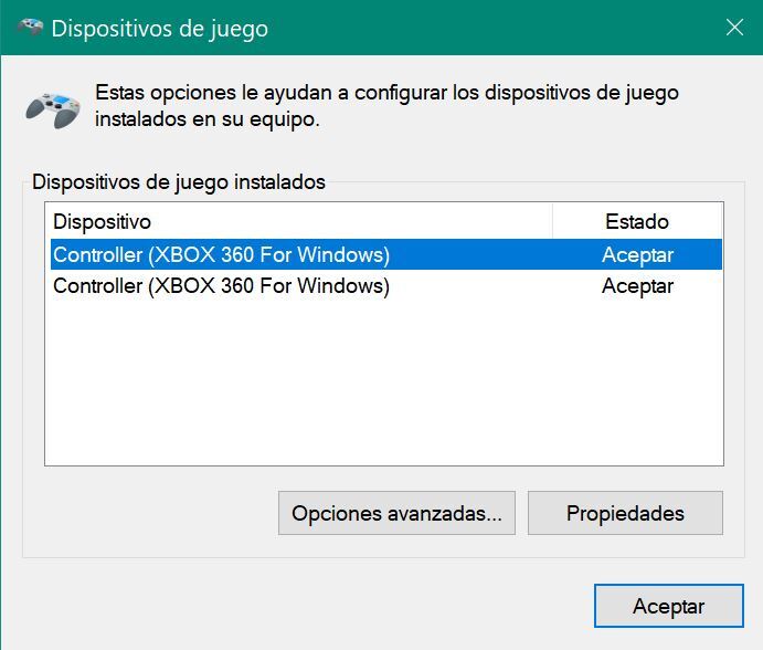

      Now, I need (I think) that on Windows Controllers A & B are recognized independently. I am sending you a screenshot of how I think they should appear in Windows.
      Another problem (that I don't know if it will exist) is if I can configure in reWASD the gyroscopes of controllers A & B independent of each other. Oh, both Controllers A & B would show up in Windows as "XBOX 360 For Windows".

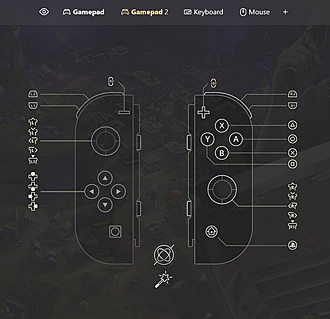

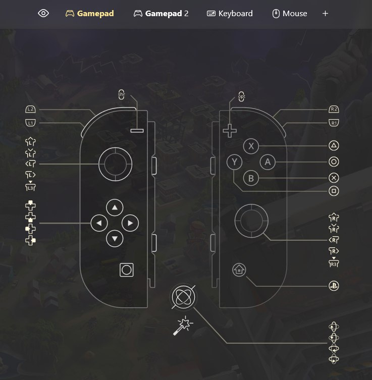

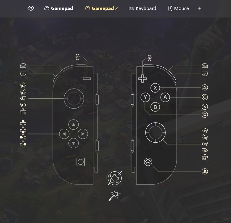

                You can try to use both gyroscopes with two joy-cons in a device group.
                To achieve this, you need to make an additional sub-config.
ID:	238200Click image for larger version

                    I bought another Right Joy-con and I have configured it as indicated by strokel. I can tell you that it works!
                    I've both of my Right Joy-cons running each with their own gyro settings and on Windows as a single Xbox 360 controller.
