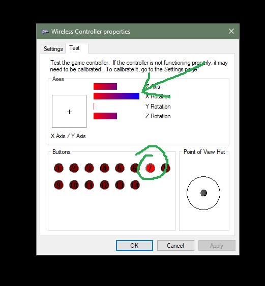

    When i press trigger, it in the same time works as a trigger and a button, as soon i start pulling it registers a button input. How to remove button input? Tnx.

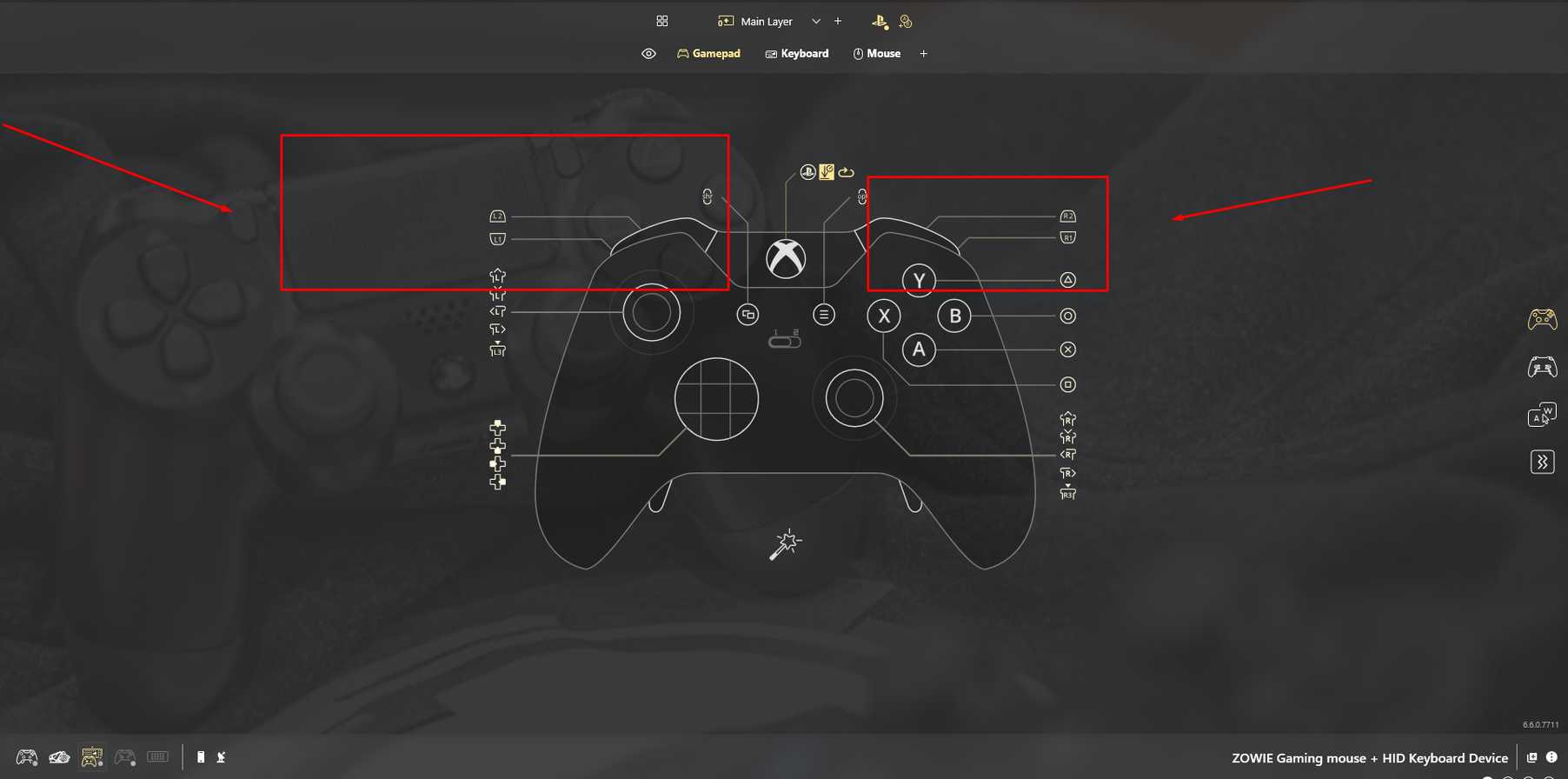

        Are you sure that you sent the correct config? There are no mappings to the triggers in reWASD.

          It doesn't matter if it's mapped or just native input, it always has 2 inputs like in the picture.
            But that is how trigger press is detected in joy.cpl
            Because it displays the very fact of pressing the trigger(Button 7) and the degree of its pressing(X rotation).
            I can suggest you test your input here: https://hardwaretester.com/gamepad
              But then if i want to map a trigger to a lets say throttle in game, it always puts button input first, and i can't map analog trigger to it. At least not with DS4 controller.

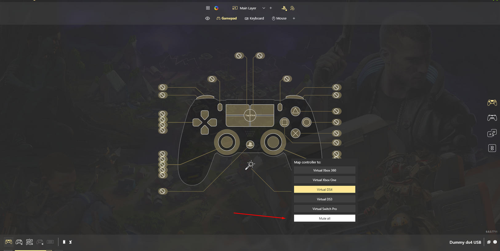

                You can Mute the native input of every key

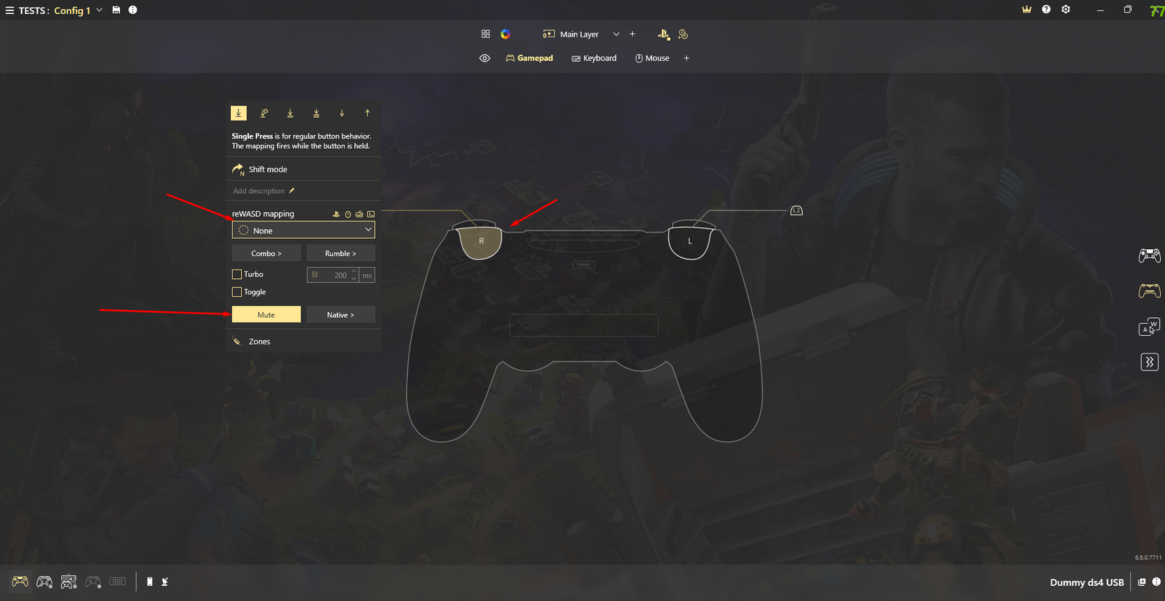

                After this step, the native input of the key will be hidden and the game will see only the mapping​
                  On virtual DS4 disabling digital trigger buttons is not possible - this is how DS4 works by design. If your game is confused by this then you should emulate Xbox One instead.
