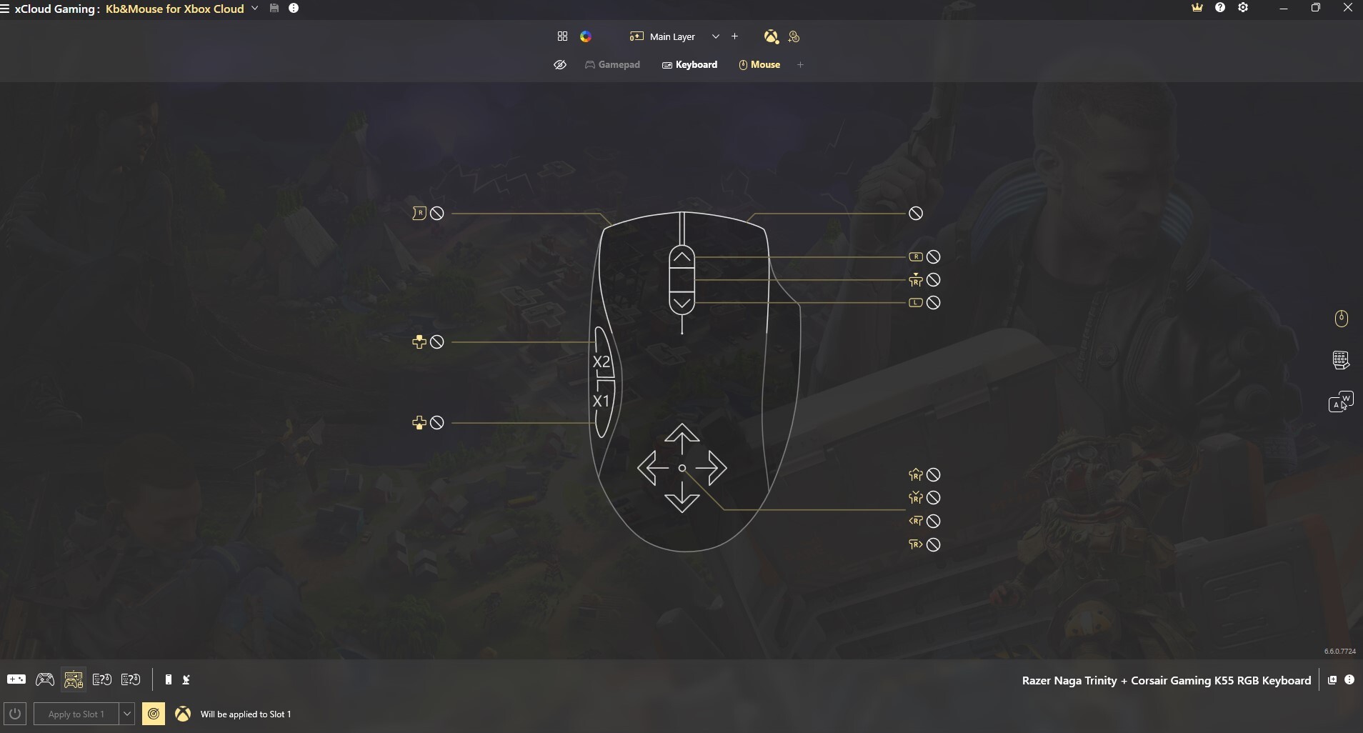

    It sounds like you didn't Mute the mouse mapping in your config, which resulted in the mouse pointer moving around the screen.
    Once you Mute the mouse mapping, check this article for instructions on how to switch between remapped and native states of your mouse for cases when you need to use the pointer.
      its is all Muted and it still does it, so i have no idea why its being like this

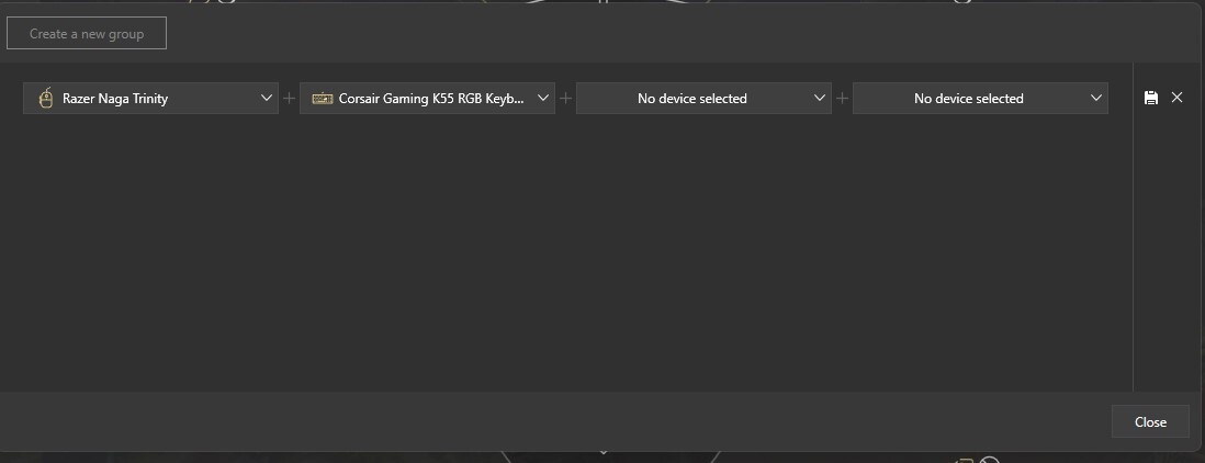

        We'll need a screenshot of your devices group editor and the config file. You can find the file by right-clicking on its name in reWASD and selecting [Open file location].
          this is all i could find, sorry ive been really ill so ive not been at the pc much, im not sure if this is what you ment or not
            The config and device group look correct. The mouse is detected as the mouse, and Mute option is turned on. Could you try to use reWASD without Autodetect? Are the same problems if you just apply the config manually?

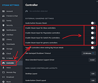

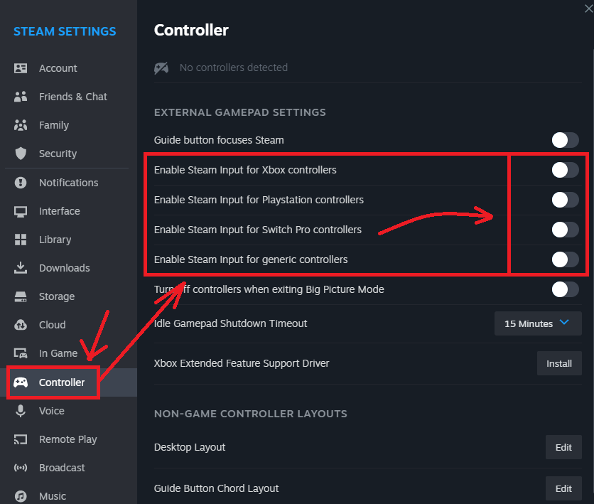

                Could you try to turn off the Steam desktop config if you have one?
                It can be found here:

                  Thank you Gogeba, seems like steam was causing interferance with the app, since im only using it for Xbox cloud gaming, when i compleately deactivated steam it works perfectly! thank you so much !
