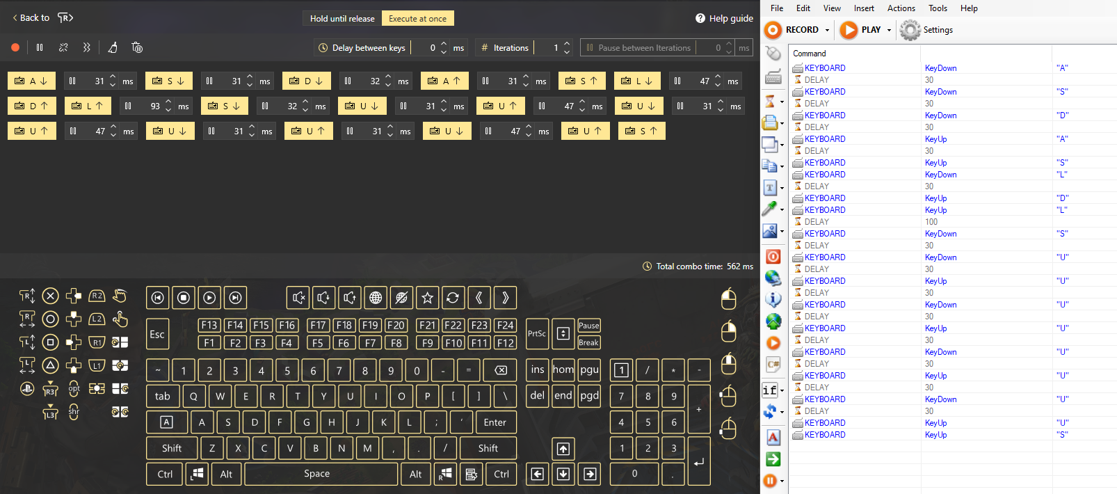

      The picture on the right is the macro I made using Jitbit.
      It's 100% accurate and it reproduces in Street Fighter 6 with 100% consistency.
      When I play that macro and tell rewasd to record it (left picture) you can see that the delays between keys are all wrong.
      But that's not the main issue. I can obviously go back and correct the timings.
      But even though I correct the combo with the right timings, rewasd WON'T reproduce it in-game with100% consistency, like the other software does.

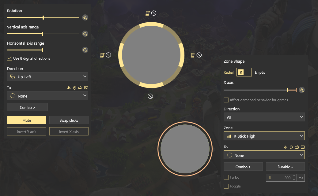

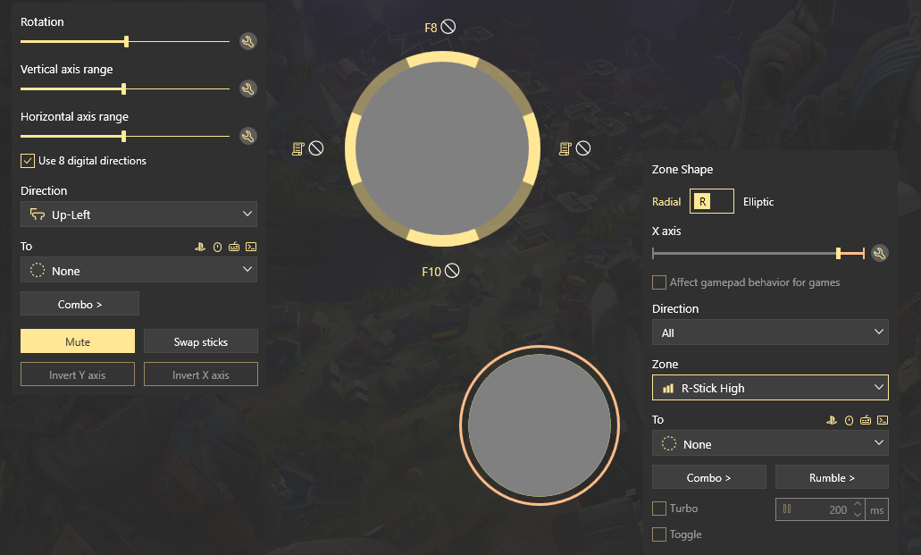

            For anyone having problems assigning combos to sticks, this is what worked for me.
            Go to "advanced settings" of the stick and increase the deadzone all the way. This way you avoid two macros playing at once and messing the inputs..
              Maxing out the [Vertical/Horizontal axis range] values would have a slightly better effect.
                How so? I think if I did that I could move the stick slightly upwards and trigger the up macro instead of the right macro, for example.
                  This would remove the diagonal zones where two Combo would activate simultaneously.
